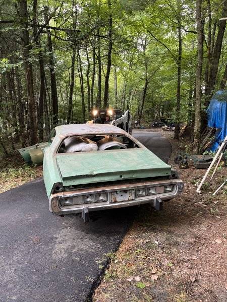

Hey everyone! It’s a pleasure to be a part of the forum. I’m from Massachusetts born and raised. Ironically I’ve been a mustang guy my whole life I’ve owned 5. All of them being a newer models… I’ve never worked with a carburetor! I’ve always wanted something older.. I got into my possession a 1974 Dodge Charger from one of my best friends for a very fair price I fell in love with I’m looking to restore. Upon owning the car I realized I lack pretty much the knowledge on most things, that’s where I’ve spent DAYS worth of time on this website doing research in an attempt to prepare myself for the task at hand. It finally occurred to me I should make an account myself! As I finally did, so I can finally chat with, communicate, and do business with everyone! I’m going to need alot of help with this project and journey I’m not afraid to admit it. So anything will count, I appreciate everything guys. Thanks for having me. Car currently has the stock rear end (no idea what that is lol), I think a 727 auto trans (which I want to sell and get an a 833 manual 4 speed for very badly), and a 400 ci big block that’s stock (also unsure the condition, tore it down but has to go to the machine shop). In the end I believe what I want is a 400/451 stroker, with an a833 4 speed, and 8 3/4 rear end. Can’t wait to chat with all of you. Please reach out. Car also needs body work in the quarters and rockers too :( I do have two brand new quarter skins for it though. Just need a path to follow and some good advice from some good knowledgeable people.

Bad news is long and arduous road ahead of you. Good news is you'll know every inch of that car inside and out and become quite proficient in auto repair/resto.
Welcome from Georgia, big adventure with this one being your first assault. Your sheet metal skills will be challenged as getting those issues resolved first is the normal approach towards getting the body back into shape. At the same time be getting engine/drive line, and interior up to your likings. Once the body is painted and you have most all parts refurbished, the assembly goes pretty quick......enjoy, its a labor of love for most all here.....

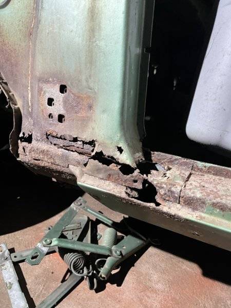

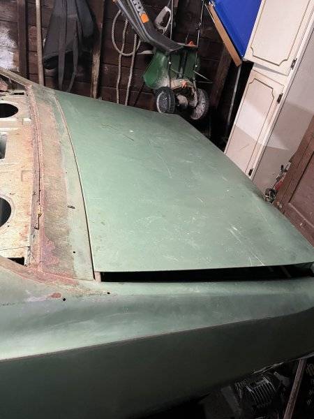

You may want to check that cowl, judging by the rust in the lower A pillars and rockers.
You've already got a difficult or expensive job to fix those.
If the cowl is rusted out (a common issue on 71-74 cars), then it's even more so.
Remove the plastic vent screens over the large holes under the wipers.
Put your hand and arm in as far as it will go.
Feel around the volcano-like protruding vent "stacks".
pay particular attention to the bottoms where they meet the surface below them.
There were two different quarter patches made.
The one made by Goodmark/Sherman is good (not great).
The "other one" is AWFUL.
If you post a pic, we can tell you which one they are.

The cowl, seems to me not rotted believe it or not, I’ll go and get some pics. I have por 15’d the entire floor pan inside and out, firewall, and inner roof as well.
