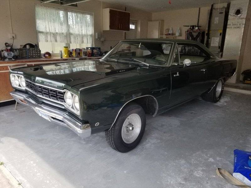

Have a 1968 roadrunner, putting a 1969 383 in thats bored .040, exhaust 3 inch to the rear, 4 speed. Have the 516 heads that are stock, and I want to liven these things up. Any sugestions ?
