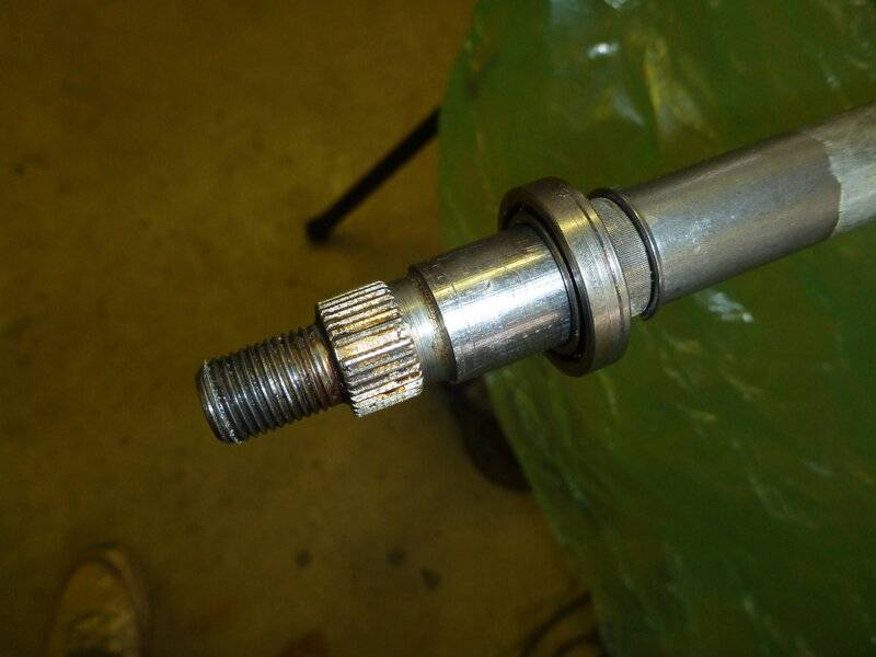

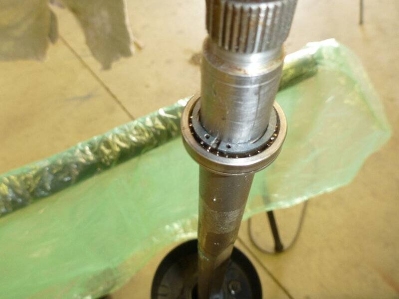

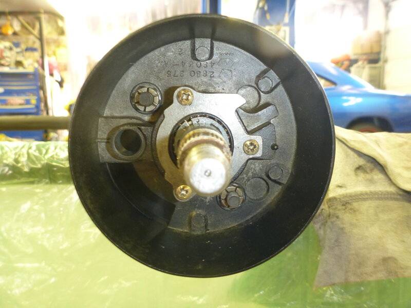

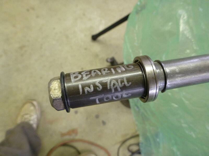

Here I thought pictures from the service manual with arrows would be helpful.. DadsBee you rock...
