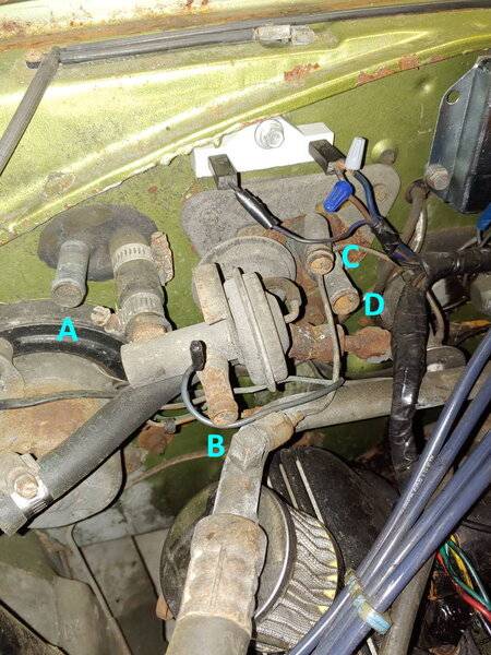

This is what I have on my firewall. This is a driver, 100% survivor, not a restoration project so I'm not worried about date-coded hoses or anything like that. Connections B and C are slightly smaller diameter than A and D; I presume the hookup goes like this:
A: return to engine
B and C: looped together
D: feed from engine
Yes? Maybe?

B connection is an added heater control valve that doesn’t belong to the car.
C and D connections are the factory heater control valve that probably leaks or somehow won’t work. Your temp control cable connects to this valve originally.
Simplest way to start is You can Connect both hoses to A and remove the valve at B to have full heat all the time. This will check to see if the heater core is good.
I have run this way and you can open the windows slightly or just turn the system off of you get too hot. Or when cold enough outside it’s fine at 100% heat.
But perhaps the added valve works as it should and the system will be fine with it on there.
The heater hose on the intake is hot into the heater, the hose on the water pump is return. On the heater core A is return and the other is hot water in.
Engine connections should have a 1/2” and a 5/8” size. But your heater core will be both 5/8”. The stock heater control valve has the 1/2 and 5/8 connections.

Thank you for the tips. I guess I'll start the hunt for both a valve, and a core. And a manual, to see how much "fun" this is going to be. And while I have it apart, I may as well toss in an a/c core too...
I did get new hoses on, and cut to length...but just clamped around bolts at the firewall end for now. I didn't really want to fill the cabin and the carpet, with coolant...at least, not tonight. Main goal tonight was to do a fresh fill with good antifreeze, since she lives "up north" now!
