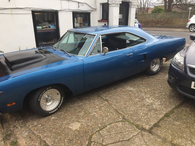

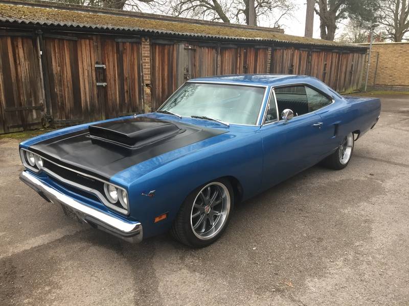

My 70 Satellite below , thanks for any help.

Mate, welcome aboard, love the car. The rear's might be ok with the 14" wheels and 245/60, but the fronts with 14" wheels need a 215/70 to get to a similar overall diameter. I made that mistake (225/60 on the front) and mine looked silly too. If you're buying new 15" wheels it won't matter anyway, but just use an online tyre diameter calculator to get to a similar overall diameter to what you have now with the bigger wheels. I think the 70's have more room in the rear wheelwells so you might get a 265 or more under there.
love the car but hate those wheels,sorry. Im old school 235/60/15 on front 275/60/15 on back or police rims and caps

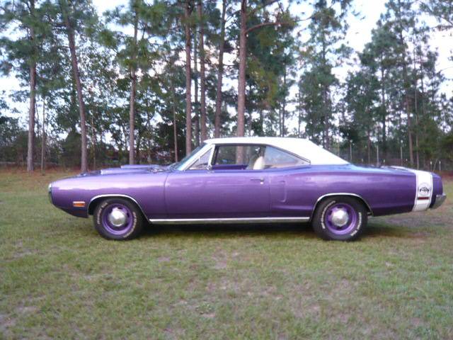

I have a 1970 Coronet, originally with 14" Wheels but for me too small so I opted for period correct Rallye 15"x7" in front and 15"X8" in the rear. Wanting a fatter tire to fill the rear wheel well i went with 275/60/15 and then chose 225/70/15 in front, thus the tires have the same diameter. Rims in rear have 4,5" backspacing. I added a Hotchkis tubular "racing" sway bar in the front to stiffen her up and had the rear springs redone to HD standard going to a specialst telling him I wanted the car to take a full load of passengers plus a full trunk and still have it handle well. Im extremely happy with the setup, steering is great and grip is superb with the Cooper Cobra GT tires. And I think it looks good too. Here are included pictures.
Oh yes and I was missing the center caps but I have them now in Argent (dark gun metal?) Still kinda like the "hot rod" looks without the center caps tho.

If you decide on 275/60/15 you can have Max rim width of 9", they work very well with 8" (mine are 8" and 4,5 Backspace no rubbing anywhere)
A note on 70 Profile : Above 225/70/15, remember your tire diameter will go up and the sidewall is going to be TALL. Might look cool going straight but as soon as you decide to take a corner that tire can "fold" or slip... I suppose thats ok as long as you dont expect cornering performance. :) Just my 2£'a worth:steering:
