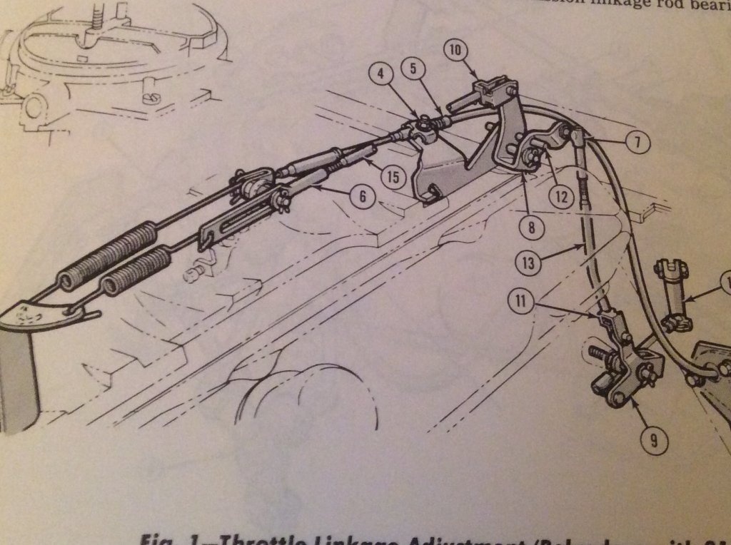

The only external adjustment is the throttle pressure control valve which should be all the way back at full throttle. There is an adjustment on the valve body. Tried to upload stuff from service manual file to big???
On the Service Diagnosis Page Under shifts erratic . low fluid, aerated fluid, wrong throttle linkage adjustment or gearshift control linkage adjustment, Hydraulic pressures too high/low, governor sticking, oil filter clogged, valve body malfunction or leakage, clutches or servos sticking over not operating, faulty oil pump worn or broken input shaft and/or reaction shaft support rings. The simple stuff first, hard stuff last. A service is a must if you want to dig to a trans. I burned up the clutches in my trans and dug into the trans and fixed it myself, never did any trans work before. If you ever do it yourself read trans service start to finish FIRST. Several times doesn't hurt, there is at least one measurement you what to take before you rip into it. The internal adjustment is the Line pressure adjustment.
Fran has it right. Lengthening any one of the adjustments may help a little.
Picture of throttle control out of a 1966 service manual.
