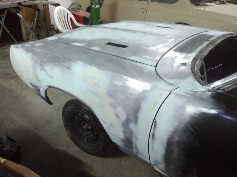

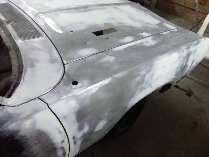

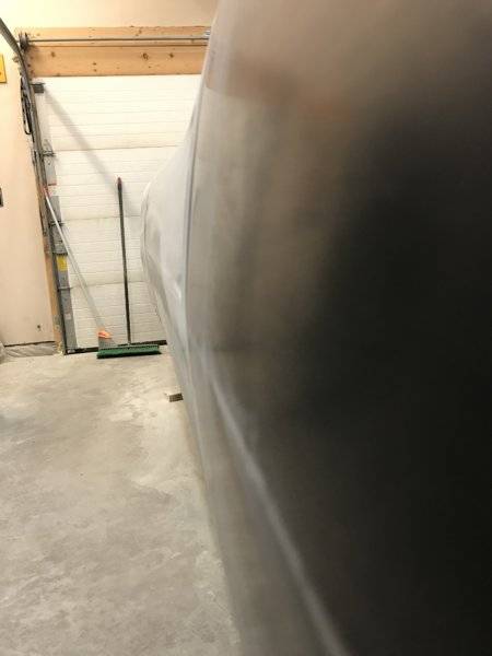

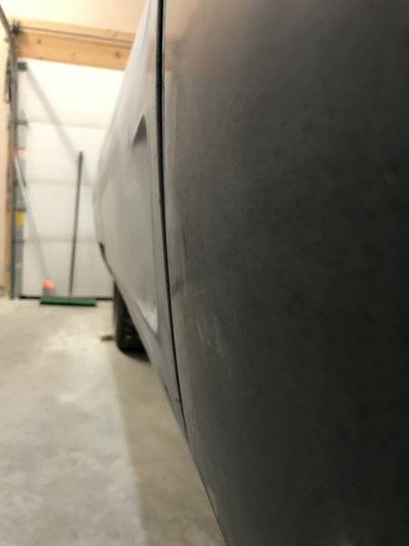

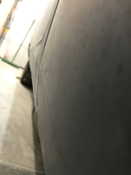

hi folks, looking for your suggestions on how to address this alignment issue in the photo. Other than this fitment issue everything else lines up. Original doors and new AMD fenders on both sides. The driver side fits perfect, only the passenger side has this issue.
The only solution I’ve come up with so far is to cut the inner fender brace (small V shape) to allow the fender to bend in the middle and push out to where I can the then tack and re weld the brace back up. This may throw off other fitment at the bottom but I don’t have to make up much so might be okay.
Thoughts??

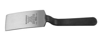

do you have a spoon? like this?
that might help to get that roll out you need.. its just a thought..

I think your on the right track. It may bend if you support the top and bottom with the fender laying horizontal. Just step on the inner brace a little at a time. Cushion it and measure your progress.

Thanks for the responses guys. Going to sleep on it and probably try cutting the inner brace to allow the fender to bend out in the middle a little. Will let you know how it goes.

I'd be doing as 493 Mike suggested before cutting anything. I fitted my fender to door today, on my Bee, that didn't look right after paint and assembly. A bit of fender out at the bottom and pushed up hard, door in at bottom, out at top and the contours now match perfect.

You can also utilize a 4 x 4 block behind the fender brace and the body. Leave the top of the fender attached and the bottom loose. May take a bit to determine the right size block. Place that in the area in question and push the fender inward to force that area out........

It is a tough spot with that brace in place....It will take a fair amount of force.....You dont want to just bend the lip out because it will be a fair amount of filler to level it out.....

It may be the picture but the top of the door and the top of the rear fender are below the cowl by a 1/4 inch....
I wouldnt hesitate to put a slice in that brace, if that is what it needs........ Ive done it and more......unmolested door dictates to an aftermarket fender every time

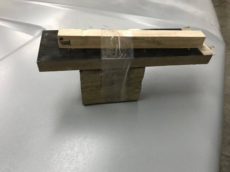

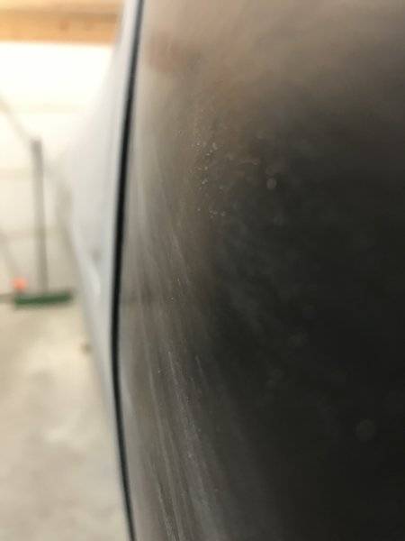

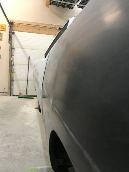

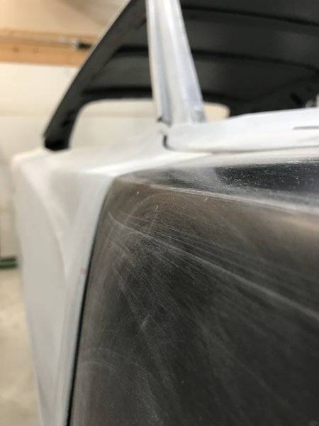

It worked!!! Thanks moparnation74! And thanks everyone for your quick replies. Some photos-
What I used:
After shot!!!
