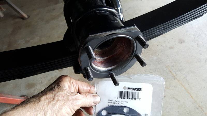

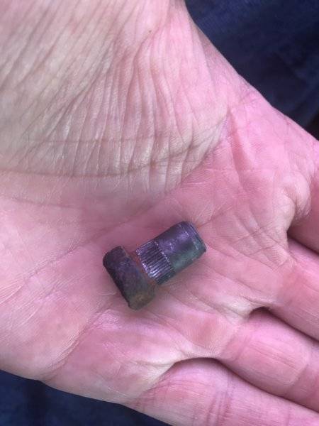

I broke off one of the axle studs that mount the axle and wheel hub to the axle housing. There are 5 of them, it is a knurled stud. Just like the wheel hub studs. But much smaller.
Stopped at local part stores and they don’t sell any knurled studs this small. Nothing I can see on EBay. I guess the correct terminology would be axle stud ? Where as the studs that hold the actual wheels on are wheel hub studs, don’t know the correct term commonly used on the axle studs ?
Maybe they are called rear axle retainer studs ? But, I can’t find them

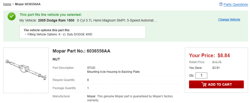

I found part number - 6036556AA. Just can’t find them outside of EBay. Where they are too much.

Have you tried a Mopar dealer or apply a different application in a search? 6036556AA evidently fits my 2005 ram 9-1/4 as well.

Yeah, I was thinking of that. I think it’s pretty important to have all 5 there. Especially, because all the original ones have part of the head originally grinded off on one side. They lose strength in that design as is.
