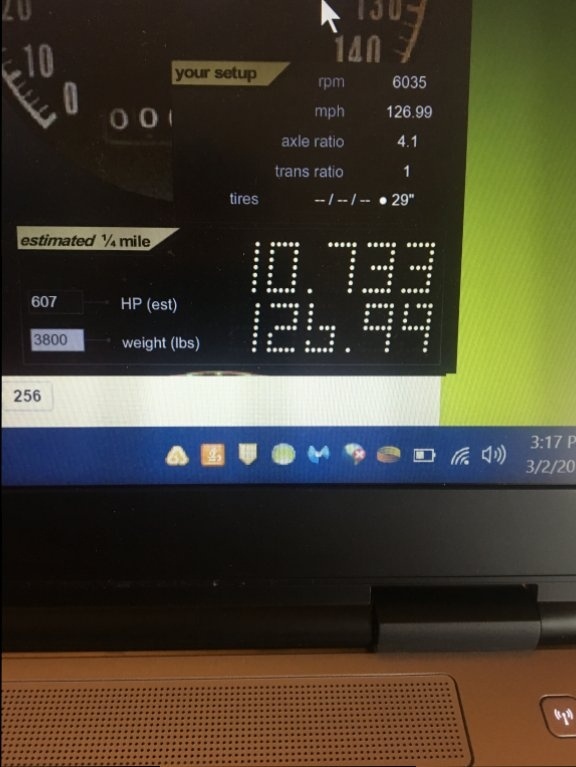

Also ran it through a calculator on another site and it says I should run through the traps at about 5900 rpm with the 4.10 which would be ideal.
Here's what it has me down for with the 4.10
