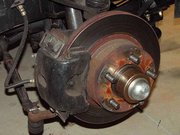

I have a 63 Polara that had a front disc brake conversion installed, but nobody knows what kit was put on it. Without taking thigs apart I can see that the caliper bracket on passenger side has part #2627BL cast onto it. Is that enough for somebody to know what parts were used in the swap so that I can look up correct caliper and pads or do I have to tear it down further.
Attached is a pic

OK so if I looked up calipers for 62-64 B & E body they would probably be the correct ones? This car has fatman 2 inch drop spindles on it.

If it were me I would just call MBM and talk to them about what you have. Otherwise, take what you have to your local parts store and compare.
Those sure look like the 73 and later A body calipers that I put on my Fury. I'll bet that the conversion was made from that model. Very common. BTW, is your bleeder screw at the top? Looks like it's upside down... As far as the fluid level, look for a pinched steel line or a collapsed rubber hose.
Look like a body but I see the bleeder at the top so that's good .
The guy I bought it from said be thought they might have been from a Volare? Does that sound right?
That's what it looks like to me. A Volare, A-body (Scamp, duster, ect) I did the swap on my front for my '71 and it looks VERY similar to what I have now. More inspecting needs to be done with the brake fluid issue in my opinion
