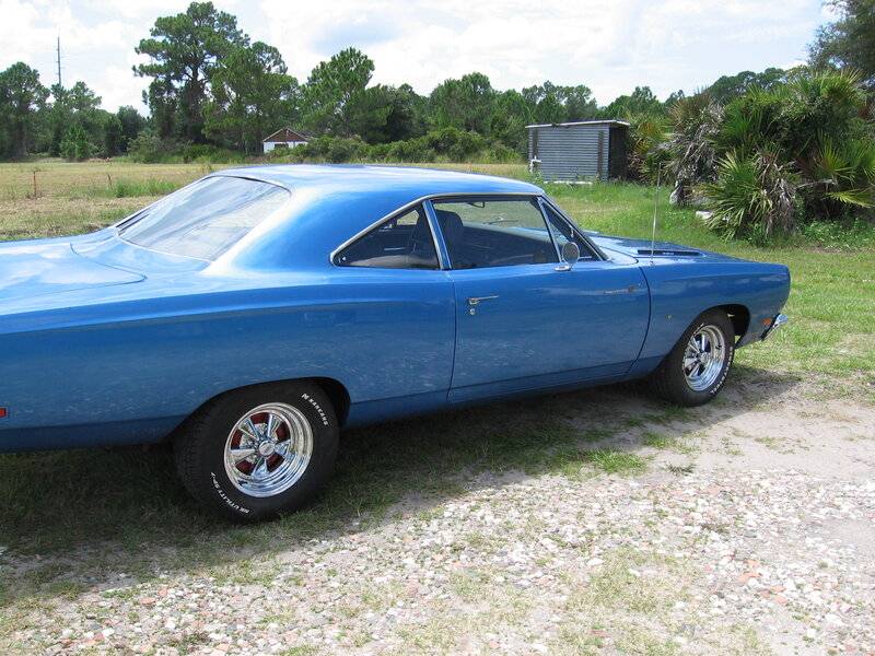

2 1/2 inch recurve spring's gave my car that nice rake we looked for in the 60's and 70's. Got six leaf makes the car stable in the rear. No sway bar yet. But going to put one in this next year. It is not too stiff in the rear which I was thinking might be the fact. Did have to pull the car down a little too hook up the shocks. But don't have any problem with them either. Just can't get 10's on the rear of most of these mopars with out doing a tub job. But then that ran into so much work decided not to go their. Doing mini tub's messes with the back seat and your spring hangers. One thing lead's to another. So here is a pic.

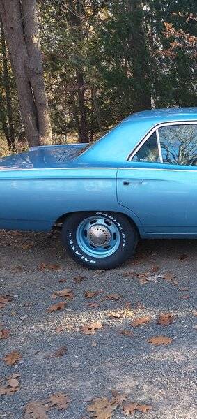

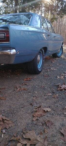

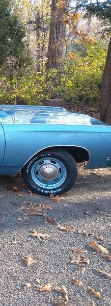

275/60 and 235/60 on a 7 inch wide 15. No mods.
Just flew with the advice here on the forum. I have a 2.76 which just rolled it to near triple digit speeds around 3600 rpm

Be careful not to mix apples and oranges when getting advice on this. Optimum offsets and widths area little different for 3rd gen Charger than 2nd gen B bodies. If you want the best advice, take your own: Measure the width and offset of your current rims/tires and figure what you want from there. Then you know you will have it right.
I do agree 100% -just providing some visual context for a 15 inch rim and tire combo. Good luck!
