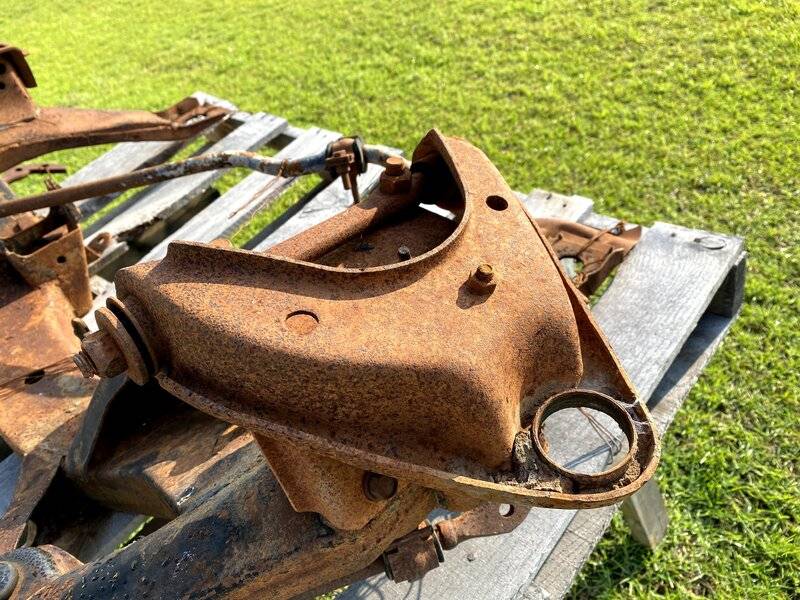

Still digging parts out I will let you know what I find in the next 2 days..

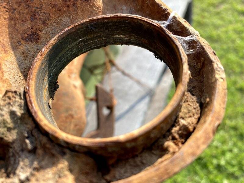

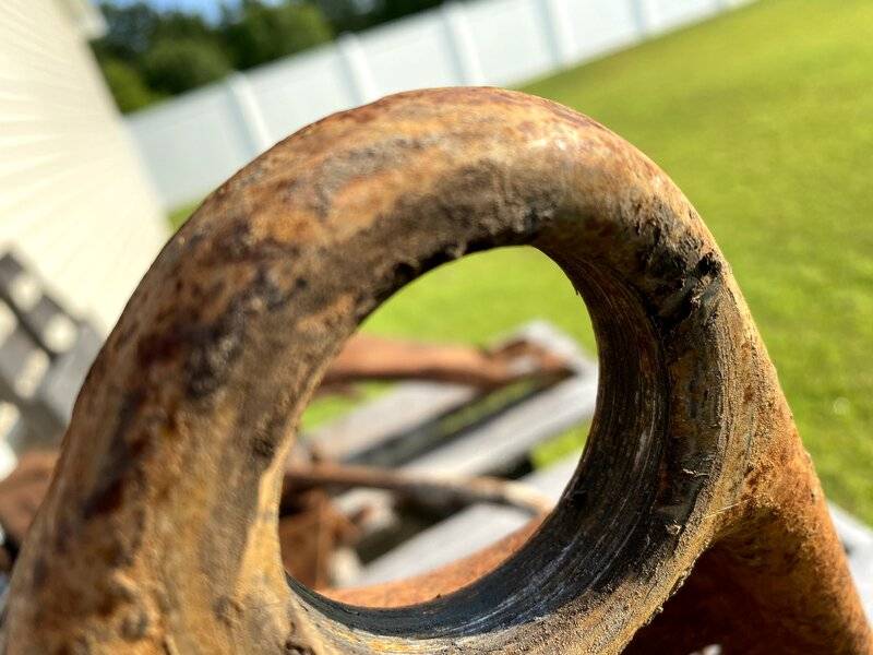

I have one for you. Threads look usable. Feed the wife and I burgers on Saturday and I will bring it for you.
Be aware that at some point they changed the design from thread in to press in (consensus seems to be late 73 to early 74) and sometimes its: A- hard to tell them apart, and B- easy for someone who thinks it's a press in to press out a screw in BJ.
It's also super easy to cross thread those odd, rounded threads.
Press in is lower control arm only. The 74 parts manual still calls for the 2298534 upper joint which is a screw in.
