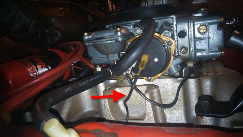

the one to the carb could be a tap for power to an electric choke

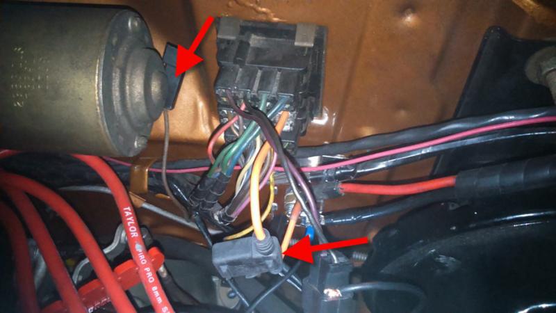

@badlite : is the orange cable the fuse link? Is there a way I can test with a multimeter if it is fried?
Anyone knows what the brown cable is for? It is not connected and has never been as long as I can remember.
This is a picture of the wire to the carb.
Yes, that's the fusible link. Check with your tester that you have power at the lower connection of that wire and then again by jamming your test probe into where the wire goes into the black bulkhead connector... You should have 12 volts in both places...if it's fried you will only see 12 volts at one end of that wire.
Also it looks like it has a replaceable fuse in the center of it (that little black box attached to the center of the wire) try to open it and check the fuse.
