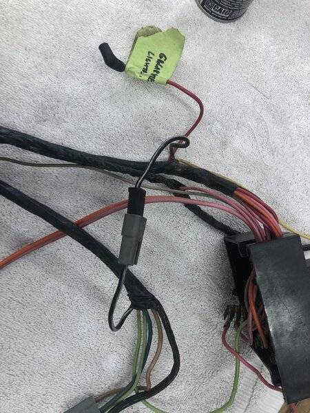

Picture one. The red wire with the angle plug is the cigar lighter. The black with the tracer is the ground.

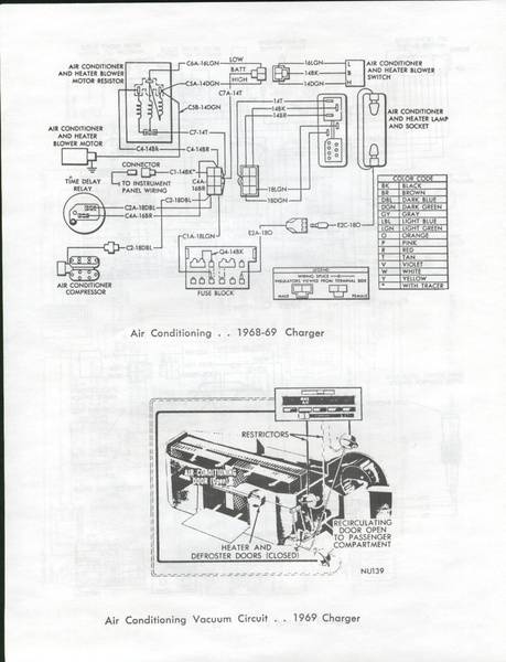

Picture two. White and should be pink not red. But those go to the brake light switch. Sorry I was wrong red goes to the flasher then comes out of the flasher as apink wire to the brake light switch. White goes there to. Here is a picture with arrows pointing them out.

The black is not a ground. The lighter grounds to the dash frame. The black with the tracer is your power feed to the blower switch. The browns as said two taped together go to the washer switch. One brown will go to the wiper switch. The one brown with the u shape cut on the insulator goes to the wiper switch resistor if it is 3 speed. If two speed it is just taped to the harness. The white and pink single wires go to the brake light switch. Not the flasher.

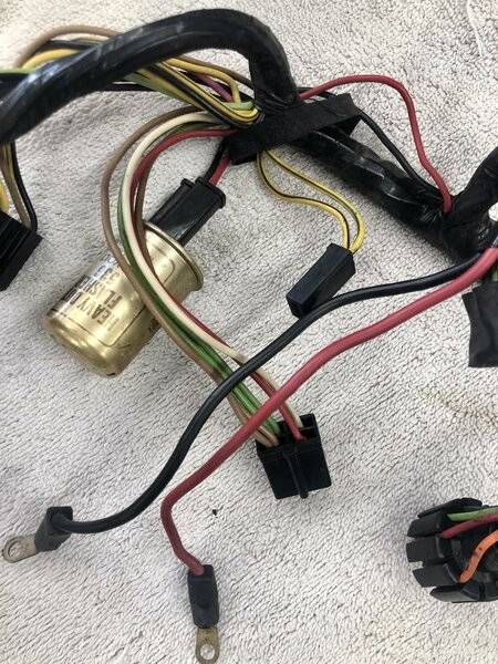

How about this black connector with two yellow wires with black tracers in the middle of the pic? (To the capacitor on the gauge cluster?)
And pnora, does that black wire with two thin tracers plug into the black wire with a thick and thin tracer from the heater/AC harness like pictured here?
Yes that is the collector for the black wire. The yellow with the black tracer goes to the buzzer that tells you the lights are left on when you open the door.
Okay, I don’t see a buzzer present, but perhaps someone previously removed it.

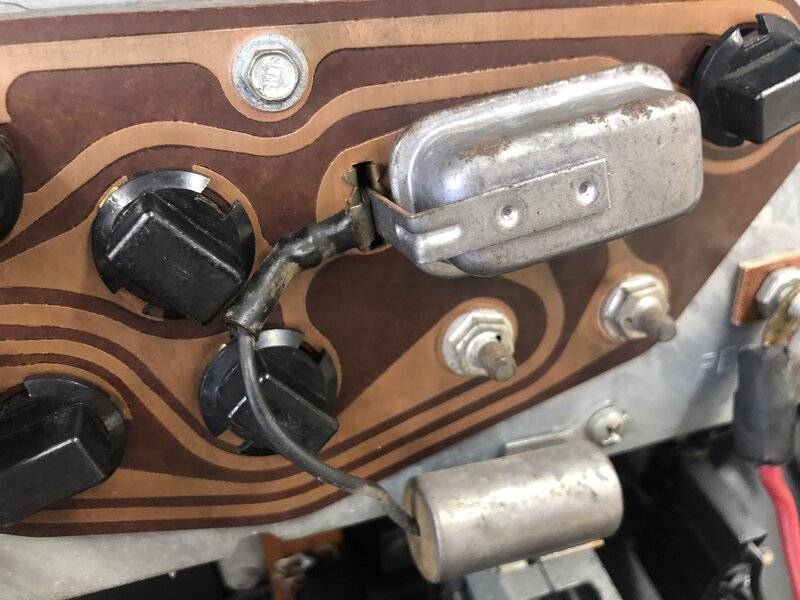

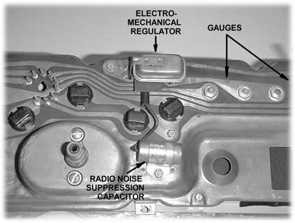

Then what does this capacitor on the gauge cluster plug into?
The voltage limiter. I goes in the 12 volt keyed female slot on the circuit board and the limiter plugs in the same slot with it. I am not sure on the buzzer but I do believe it most likely came with certain option packages. It is possible your car did not have that option. The main harness is made for all models so if it was an added option it would plug right in.

I was not sure on the black white tracer wire. Glad you caught that. But look at the schematic above it shows the red going to the flasher then changes to pink to the switch. I would agree with you that both red and white go to the brake switch. But why do they show the flasher in the middle of the circuit?
Don't let it confuse you. At the flasher there are 2 pinks piggy backed at the one terminal. One pink is from the fuse block so it is constant 12 volts and the other pink just goes over to the brake pedal switch. The flashers other red wire then feeds the 4 way flasher switch. Red is not the source of the 12 volts. Pink is.
Does this look correct?

No... the middle one which is the input for the VL
It uses to carry a carboard piece for isolation of the condenser wire with VL chassis just in case, to save from an accidental short. ALTHOUGHT if correctly inserted and wire cover in good conditions is not needed, just extra safe.
Thanks Nacho, I will change it over to the middle one.

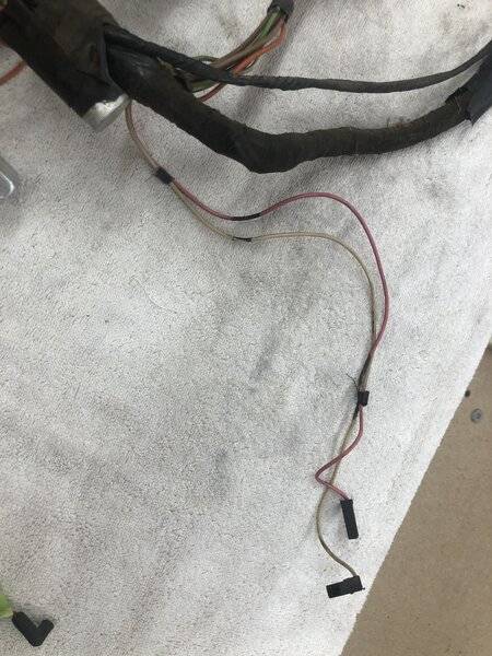

I have my dash harness all sorted out and in place except for 2 wires that are part of the AC/heat harness, I think..... where does this brown and blue wire go?
