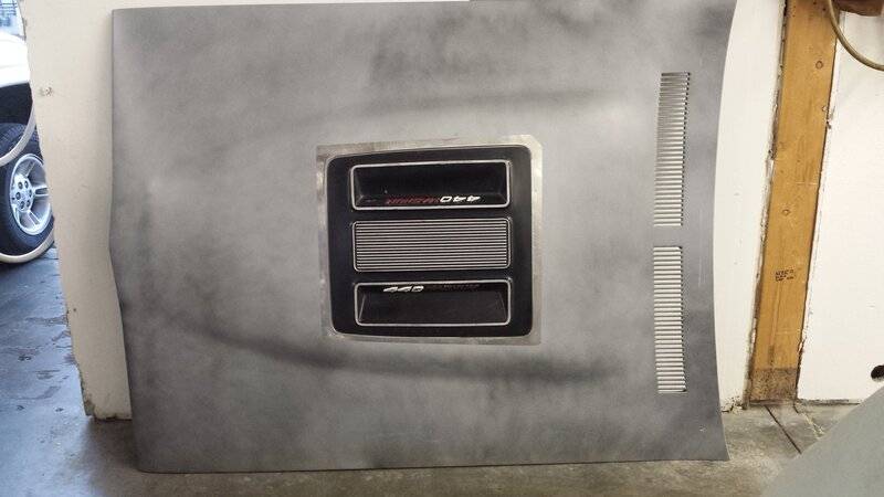

Guess maybe I have one of the 26 hoods made

Hmmmm. My buddy's had the vacuum switch inside the car for the Air Grabber. The Fresh Air door (air grabber) came up on the hood when the switch was to "Open". That was a GREAT thing to see as he rolled up to the line. :) The Air Grabber had something on the side that could be read when the AG was open. Dont remember what it said?? Best, B.
Well that doesnt help. I was hoping a high impact color would have narrowed it down to a 71
