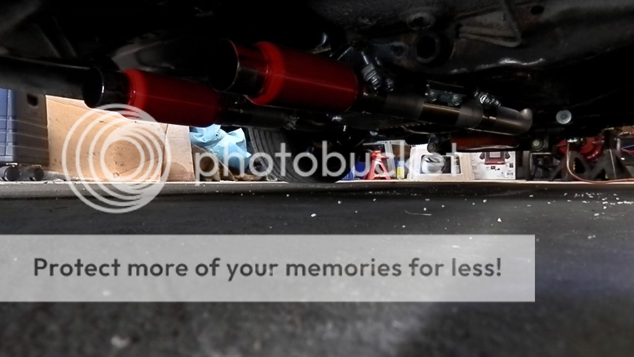

Need help finding a miss that I'm having with my RB. Sitting inside, in park, I rev the engine to 2500-3000 and can hear it. Haven't taken it out on the road, as I want to find the miss first. Here is what I've done:
1. Checked all the plug wires for leaks, the the garage completely dark.. No sparks.
2. Did an ohms test and all the wires were between 15.60 and 16.
3. Hooked my timing light up to all the wires and the light lit on all of them.
Note: Dist is a Mopar performance electronic with no vacuum hose hook to it. Using s ClassicHEI ignition system on it.
Thanks for any help.
Beekeeper. Right now I'm running dual 600 edelbrocks.
Forgot to mention, it's kinda hard to hear. If you use some ear buds, you can hear it better.
