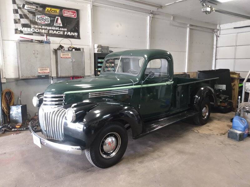

A buddy of mine recently bought a 1941 Chevy pick-up and had it towed to my shop. It is in amazing condition, touted as "all original". My buddy never drove or rode in vehicle before purchase. This truck has the 4 speed trans option, which is a non synchronized unit with straight cut gears and creeper gear. Problem is I am having one heck of a time even upshifting this thing without major gear clash, and downshifting doesn't happen unless basically stopped. He wants to be able to drive the kids into town every now and then, but city driving would be pretty damn frustrating unless he learns the "trick" to shifting her. Clutch operates very good, into creeper or reverse when hot no problem. New fluid. Anybody have any real world advice before we take her out and just trial and error it some more ? Thanks.

A buddy of mine recently bought a 1941 Chevy pick-up and had it towed to my shop. It is in amazing condition, touted as "all original". My buddy never drove or rode in vehicle before purchase. This truck has the 4 speed trans option, which is a non synchronized unit with straight cut gears and creeper gear. Problem is I am having one heck of a time even upshifting this thing without major gear clash, and downshifting doesn't happen unless basically stopped. He wants to be able to drive the kids into town every now and then, but city driving would be pretty damn frustrating unless he learns the "trick" to shifting her. Clutch operates very good, into creeper or reverse when hot no problem. New fluid. Anybody have any real world advice before we take her out and just trial and error it some more ? Thanks.View attachment 1271980
