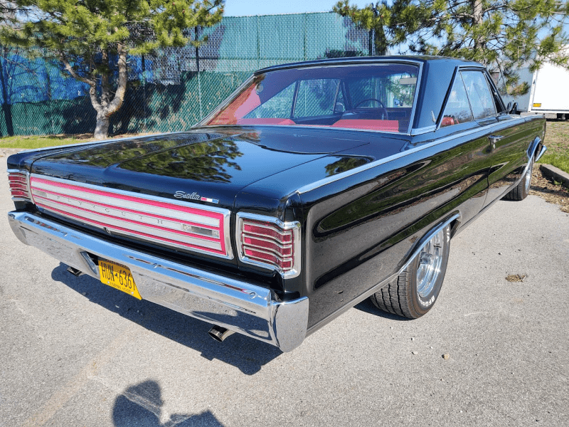

Mine are 15x7 with 4.25 BS. on both cars
And I have plenty of room both sides.

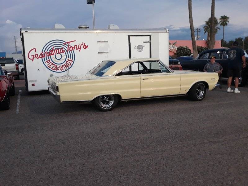

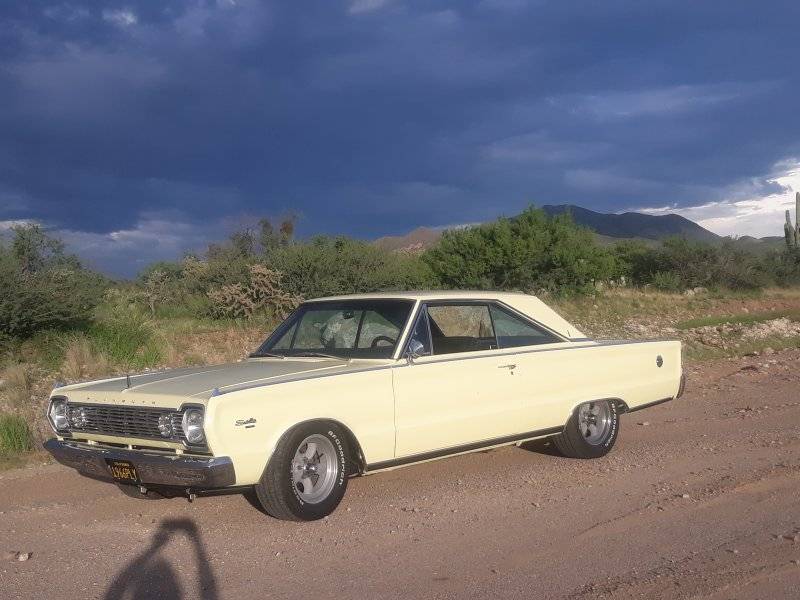

You can fit a 15" X 8" with 4.5" backspace on the rear but it's tight you need good bushings and variations between wheel wells could even cause rubbing on an uneven surface.
245/60 tire I wouldn't go any larger mine do fit fine.
I have 15" X 7" Ford wheels on the front with a 215/65 tire they too have zero offset I believe.
