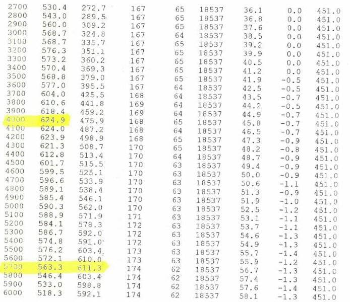

I'm also very happy with my 451 but if I do it all over I would do the 470, that's just my opinion. I have TF240 on mine with a RPM intake and a flat tappet cam that produces between 12-13 inches vacuum to retain power brakes. I did try the performer intake and it was equal to the rpm up to 3800rpm and after that the rpm just killed it by 35hp. I will include my Dyno sheet for you to look at and I too emphasized drive ability on the street. I wanted the most in the midrange where I do most of my driving. Overall I'm happy with the combo, Car which is very heavy

I'm also very happy with my 451 but if I do it all over I would do the 470, that's just my opinion. I have TF240 on mine with a RPM intake and a flat tappet cam that produces between 12-13 inches vacuum to retain power brakes. I did try the performer intake and it was equal to the rpm up to 3800rpm and after that the rpm just killed it by 35hp. I will include my Dyno sheet for you to look at and I too emphasized drive ability on the street. I wanted the most in the midrange where I do most of my driving. Overall I'm happy with the combo, Car which is very heavy View attachment 722654 runs mid 11's and can drive anywhere
Dang, those are some good numbers. What cam and compression ratio do you have?
the compression is 10.75 with .045 quench which is not too bad, the cam is custom cam 236-242 but 112 LSA to have a smoother idle. I worked with both my engine builder Tom @ TK Race 514-920-0094 and Tim @ Hughes and I feel they both hit it spot on. Both these guys treated me very well and I'm pleased. My suggestion is build your engine to conform to what you want, what's going to make you happy and driving style you want to achieve. With all the knowledgeable people here you will surely get great input.
Do have the Dyno Sheets with the Performer Intake installed ?
Or the numbers at 5400-5500 Rpms from the Performer versus Rpm
Just curious on the Torque numbers comparison between both intakes up to 5500 Rpms
Sorry I looked everywhere and can't find them. I will ask the Dyno guy to see if he has records

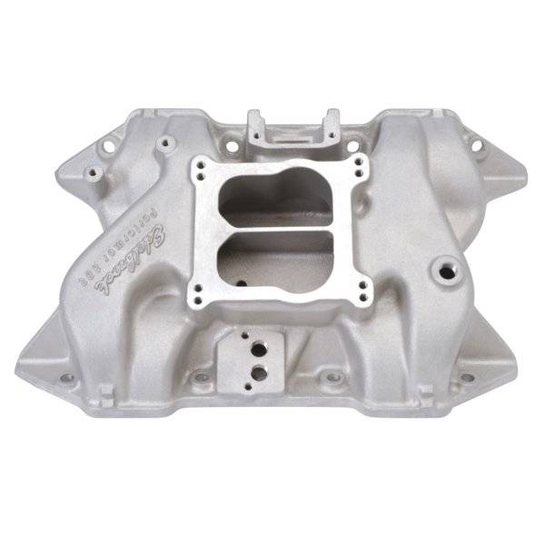

If you don't want to leave a bunch of power on the table, I think you can make the SD intake work with air cleaner base creativity, and K-member spacers.
Bigger cubic inches = greater low rpm power. That said, if you are going to restrict power with the intake, you don't need the extra cubic inches to achieve the limited power caused by the intake.
Of the intakes on your list, I'd probably pick the DP4B. Milling out the divider will get you more power.
Again, if the intake is your power bottleneck, there is limited benefit in putting on a better cylinder head.
So you can build a 512 motor with TF heads and hamstring it to 500 HP due to the intake, or you could build a 451 with less costly heads and make the 500 HP. Of course, the good news is if you build the 512/TF motor, you're an intake swap, and maybe a cam swap away from 575 HP.

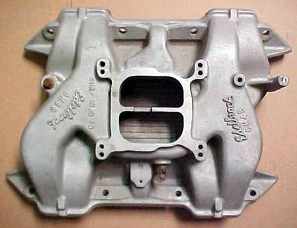

Are you sure the RPM won't fit? Especially with a low deck. We had one on a 65 Plymouth with a RB with no issue.
Doug
The current Performer 383 intake is just a revised DP4B. No need to pay a premium for an old DP4B when there are plenty of used Performer 383's around.
Doug
Definitely won't fit with the factory Ramcharger hood ductwork.
View attachment 722890 View attachment 722891
I have run across quite a few people and articles saying that the new Performers don't work nearly as well as the old DP4B. Or course that is all interweb talk, and we all know that everything posted online is true LOL.
I have both and used both. If you spend a day measuring everything about those two manifolds, you will convince yourself that they are actually identical intakes. The Performer is a DP4B flipped end for end, and a spreadbore flange added. Maybe there is a little in one over the other, but you'll be had pressed to find it, or know it, if it's there.
