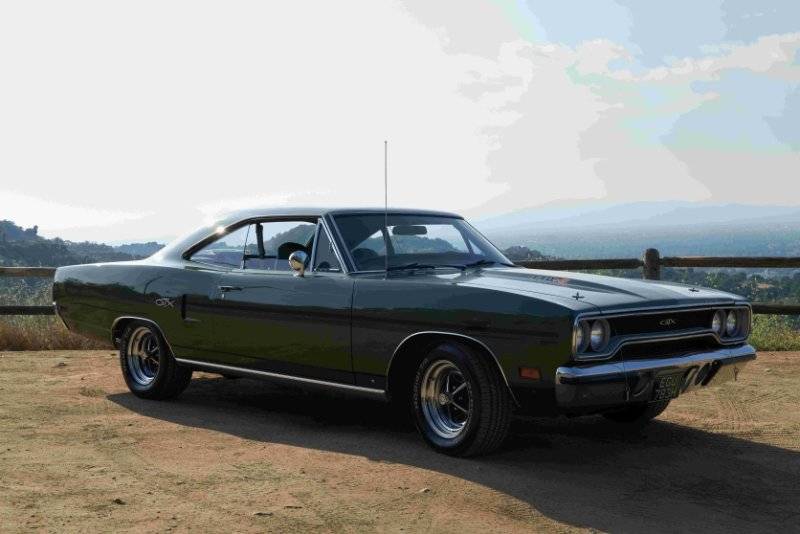

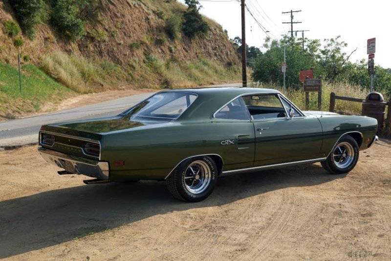

A few years since last post here. The GTX has been great and used throughtout the UK, Spain and Italy. It is now back in the USA in Beverly hills.
I just need a few small tidy up jobs and then it will be listed for sale on Hemmings. I need to fit a new dash top and have received the new part ready to fit. Can someone recommend a garage that could fit it for me in the 90210 area? Some say its a windscreen out job but obviously want to avoid that. Thank you
1970 Plymouth GTX 440-6 V-Code Auto 1 of 328. 472 BHP Race build Engine. Hauser Diff. Disc brakes all around. Gear Vendors Overdrive. Firm Feel steering. Full Apple green Leather Interior. Retro Sound (Bluetooth) Air Conditioning. Seat belts. Ivy green.

Nice car :thumbsup:
