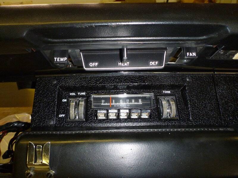

I have this radio that I’m trying to ID. I believe It’s a 1966 or so model given it’s characteristics but can’t find an exact match. It looks very similar to the 66 B body radios. Any help greatly appreciated.

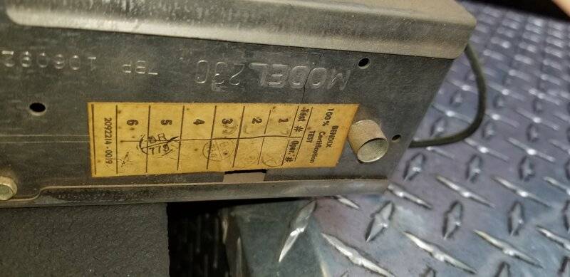

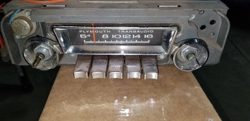

From the front it looks exactly like the 66-67 AM radio. Model number 230, but it seems to say something different.
That is a Canadian Phillips radio. AM.
Canadian radios had CHRYCO on the faceplate. I am guessing it might be an A body radio by the part number. Would fit a b body I think.
Side note when you went in to the dealership to purchase parts, you bought CHRYCO parts, not MOPAR.
I will see if I can find it in some of my information.
That would be much appreciated!
66-67 Plymouth 'B', Canadian. Final answer
