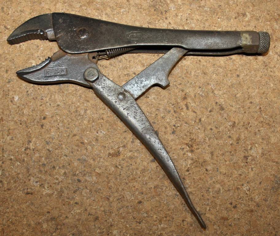

that's like cutting meat with a butter knife
(so you can understand)
what kind of steaks do you buy? horse?
sheeeit my steaks are so tender I can cut with the edge of my fork!!! :icon_fU: lol
I get what your saying, though. thanks. Now that I think about it, it did look like the box wrench did have a little gap between the wrench and nut. ****. oh well, live and learn!!

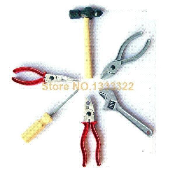

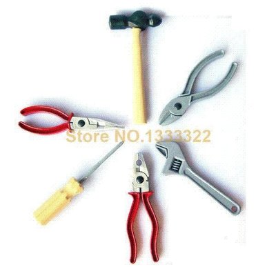

This is not a Master Mechanics tool set! Well maybe for experts...
