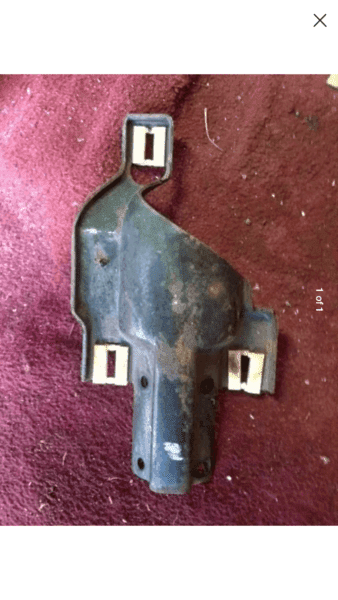

Hi I am about to mount the steering column up to the upper mounting with the upper bracket. I am still waiting for the plastic breakaway inserts for the bracket and I dont know what type of cup washers were used. I need some nice person to snap me a picture of their mounted steering column to see what type and size washer I need. I know the stud is 1/4 inch. Here is what I am referring to. The type of washer is critical to the break free operation and I want to get it right for safety reasons. Thanks!
