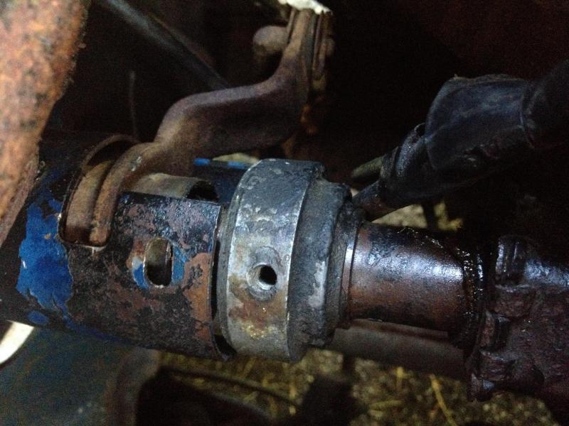

Hey there, I had to pull the column out of my 73 charger 318 the other day to replace the starter switch, and so I disconnected what I believe to be the lower column bearing to the shifter tube that is on the steering shaft under the hood. (Apologies ahead of time for calling these components what I'm calling them, as Im not sure what they really are called). I cannot figure out a way to reconnect the two.
For starters I removed two small 10mm bolts from the tube/collar. As I mentioned I cannot seem to reconnect them at all.

If the bearing pictured is the column bearing, then yes I disconnected it from what it was attached to thinking that that was what was holding the column in place. This is my first time getting into this so I really am learning as I go.

In order to re attach the bearing, what will I have to do? Is it a type of fix where I should tap it into place, or should that sleeve somehow come back down over top of the bearing?

It looks to me that you need to tap the bearing back up the shaft a little bit the sleeve won't move with the column bolted in place .but the shaft will so be careful not to tap everything upwards. Looks like it will slide very easily.

Disconnect your shift lever. If you leave it hooked up when you drop column it can pull the transmission out of park. Ask me how I know. Car rolled into garage door. Leave it disconnected until you are done hooking everything up
Got the bearing back in, it went in with some light tapping no problem! And I also learned the hard way, as mine went full force in reverse into a pile of pallets
