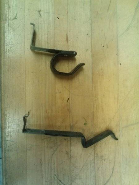

Friend of mine has a '69 RR. He has these 2 clips and need help to steer him in the right direction. His car was apart when he got it. We are thinking under the dash but where? Thanks for the help
Top one goes under the dash, to hold the dash harness. It goes on the bracket that holds the brake pedal.
Bottom one looks like it goes on the plate behind the master cylinder. It holds the harness above the master cylinder.
We appreciate the heads up moparBill!. I will pass the info along

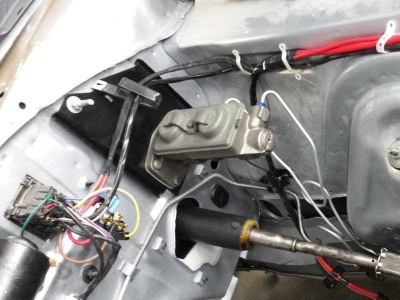

Bottom one is a little tweaked. Here is a pic of mine and where it goes...

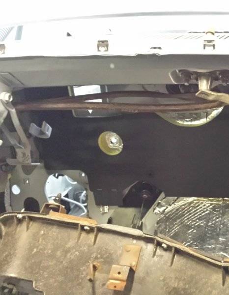

Here is a pic of the top one, I think. Mine got painted lol. Left side of pic.
Appreciate it! Makes sense now
