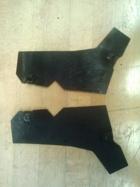

Friend of mine has a '69 RR with air grabber. He is having a time figuring out some of the decals he bought as a kit. Some we do know where they go, yet some not sure of. Is there a specific dimension where some went like the coolant decal? Also, he don't know where the 2 pieces in the second picture as well.

Those 2 black plastic pieces go on the rear interior at the rear ends of the quarter glass, kicked up edge goes to the rear of the car. They go on before the rear door panels and top metal pieces to keep the water out of the interior. It’s a 68-70 thing.
Sorry, it needed and edit.

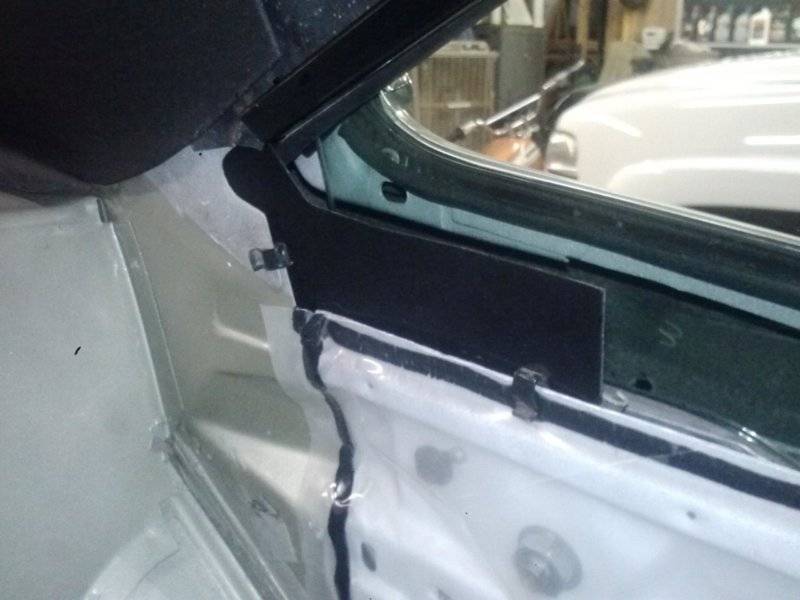

I just got the attached picture from my friend who is inquiring about these as mentioned. Is this where these go? Looks like it to me
