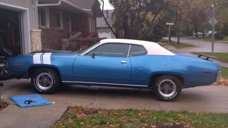

I just purchased some 5 Spoke American Racing rims from a friend. I was very excited because I've wanted some for quite a while. The fronts are straight replacements but the rears are a little big. They are 255/60/15. I tried putting them on but they will interfere with the fender lip the moment I hit a bump in the road. I bought the car with 42000 original miles so I believe the rear drums are what came with the vehicle behind the 14" steel wheels and hubcaps. Any suggestions?

4.50 is a good back space for the rear ,it looks like you have plenty of room, to me.i have 255 60 15 on my 71 tons of room there.O by the way nice car.

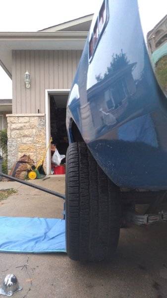

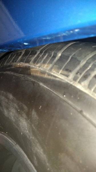

I loaded the trunk 250 lbs of children and the wheels rub. Thanks for the kind words. Sorry, not up to speed on wheel spacing terms. What do you mean .
you don't have enough backspace. I try to keep mine flush with the wheel well lip or inside some. I use a 15x8 1/2 with a 5 1/2 inch backspace and it keeps them from sticking out. it looks like you have a ton of room between the tire and leaf springs
you don't have enough backspace. I try to keep mine flush with the wheel well or inside some. I use a 15x8 1/2 with a 5 1/2 inch backspace and it keeps them from sticking out. it looks like you have a ton of room between the tire and leaf springs
Agreed. The tires aren’t your problem, the wheels are.

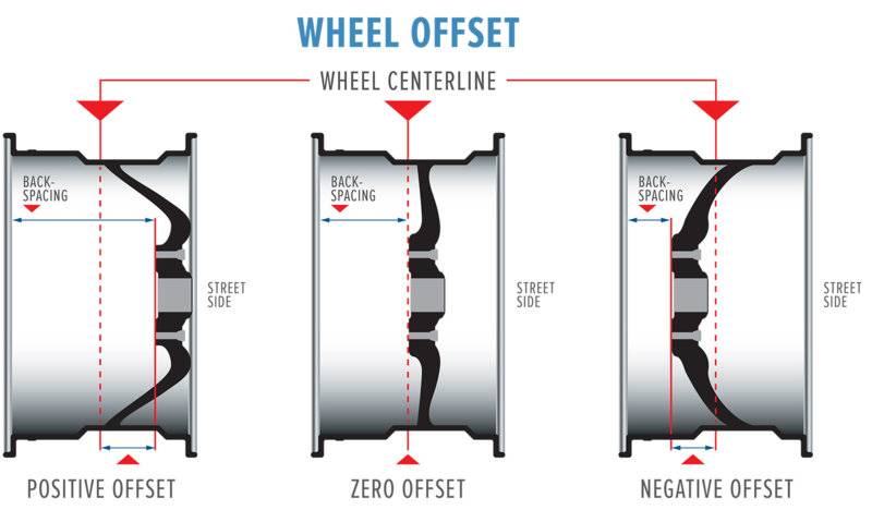

One piece torque thrusts are beautiful wheels, but most of the one piece wheels have too little backspace, making tire fitment difficult, as seen on your car. 71 runners have huge wheelwells, if the tire is in the right place. As others have mentioned, you need a backspace somewhere around 4 1/2", my guess is that yours are probably 3 1/2", meaning they are around an inch too close to the fender lip.
Backspace is measured best with the tire off the rim but it is not neccessary. Rim does have to be off the car. Lay a staight edge across the rear edge of the rim (without the tire moving it away from the rim) and using a measuring tape ,or ruler, measure to the mounting face on the wheel. That will be your backspace. It tells you how centered the tire will be in the wheelwell. More backspace, closer to the spring, less backspace, closer to the fender. Two piece wheels can be ordered with varying bs measurements, but with a one piece you are stuck with what the manufacturer decides to make.

Backspace is the amount of space between the mounting surface of the wheel (where it bolts to the brake hub), and the inside edge of the wheel. More backspace moves the wheel inwards.
And try not to get confused by 'backspace' vs. 'offset'....offset is just another way of measuring the same thing and is expressed in (+) or (-), and often in millimeters. Using the diagrams above, if you have say, an 8" wheel, a 5" backspace would be the same as a positive 1" offset. (Or 25mm). Offset is measured from the centerline of the wheel.

How much room do you have from the side of the tire to the leaf springs? Get some rims that leave you 3/4" there and you will be good. You haven't listened to the guys telling you that the back spacing on those rims wont work with your car. You should be able to easily fit 275/60/15's on the back of your car.
What almost everybody has been trying to tactfully tell you is.... you bought the wrong wheels. They are pretty, but they dont fit.
