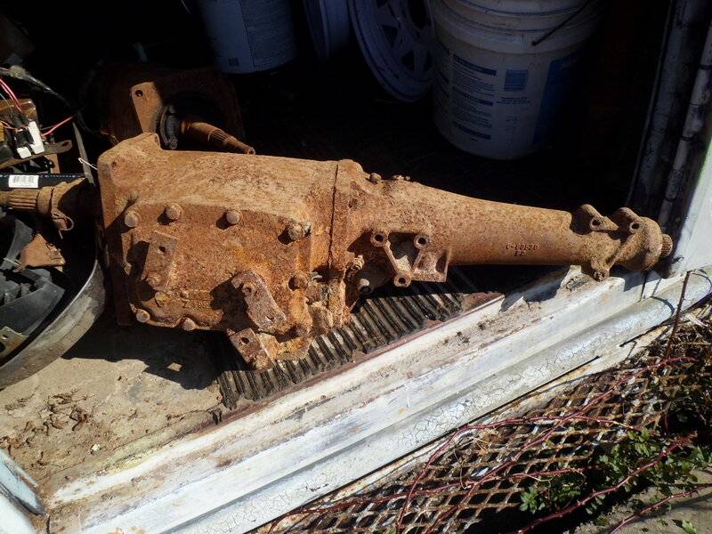

do you have a picture of the tail shaft?
yes
Thats a B & E body transmission. Depending on how much it is trimmed, you might get away with a roller pilot bearing.

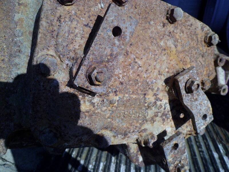

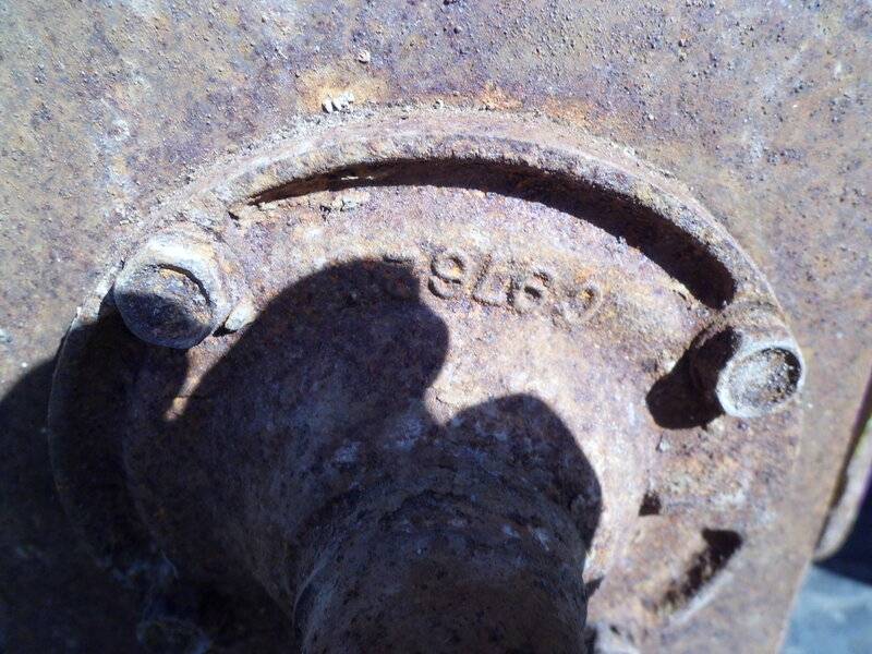

thats a 70 transmission do u know what the vin is on it?
