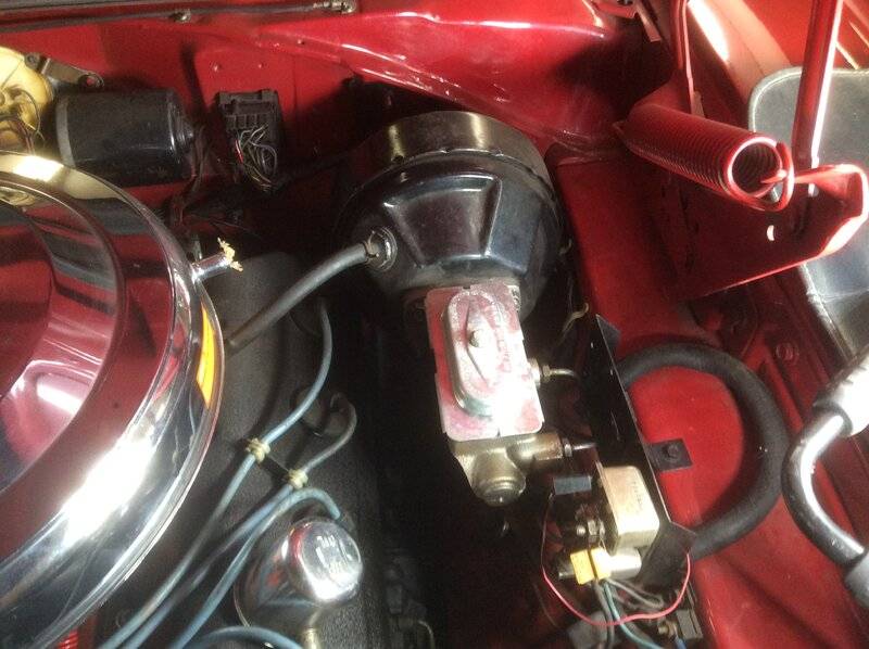

anyone know if a gen II hemi will fit in a 66 charger with stock power brake booster ? or if a small will need to be put in first? I see Dr Diff sells smaller one's. thanks

Buy a offset booster bracelet and booster. The booster actually needs to be higher than the stock location.
A regular booster won't fit a hemi bracket. Pirate Jack may have what you need or somebody else. Pic hemi with bracket.
