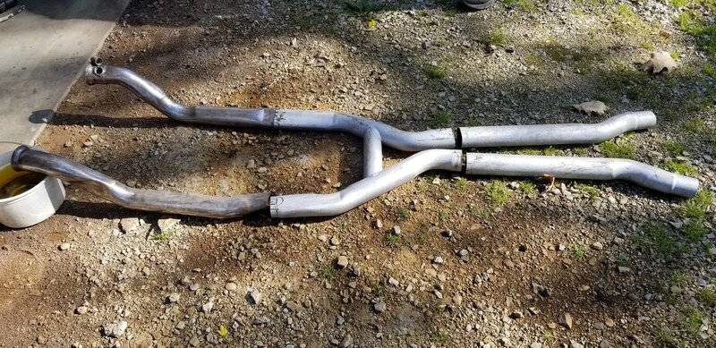

I have a aluminized old stock B-body 426 H pipe cut on eBay a couple years ago....
not much aluminum coating after sitting many years.
I had it cut for shipping purposes..... price was much cheaper...
cant remember what the cost was now.
My point is shipment can be less expensive

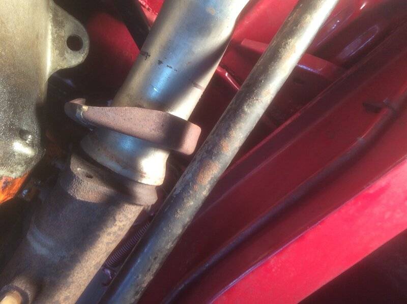

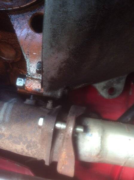

Think fixed the the problem. In the picture once the rust line. To the left of flange bolt hole note mow much metal is past the rust line. Cut the pipe parallel to rust line which allowed pipe to seat better. That excess metal caused a small gap on opposite side. Second picture is the fix, I believe.
Think fixed the the problem. In the picture once the rust line. To the left of flange bolt hole note mow much metal is past the rust line. Cut the pipe parallel to rust line which allowed pipe to seat better. That excess metal caused a small gap on opposite side. Second picture is the fix, I believe. View attachment 1109617 View attachment 1109618
yes I see... looks like the clamping steel is straight now.. Bravo
The flair looked like it was hitting the flat part flange not allowing the flair seat. Before I remove the looked on torsion bar side of pipe there was a gap of a 1/16". Say exhaust leak.
