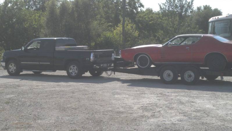

These pictures were taken when my friend and I loaded it up to take it home from his dads shop. The transport couldn't come to my door do to my narrow street.

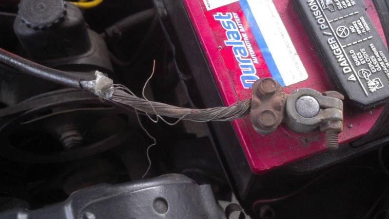

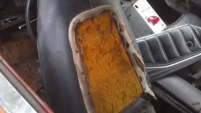

Here's some close up's in my drive way. I noticed the wiring needed replaced. It had new headers installed. I googled the part number off the side. Turns out that they are Dynomax Blackjack headers 1 3/4" primary 3" collector. Interior needs completely redone. New windshield, missing lower windshield molding. Non of the window motor's work. Headlight motor doesn't work either. K member was hit from some thing hard. Suspension is shot. Rear air shock's need replaced. Left control arm was a 69' and earlier, someone cut off the sway bar mount on it. The front sway bar is just hanging in there by the two k member mounts. Rear seat backs were gone ( got oem's from the nat's this year). Once had a rear wing installed ( no idea if stock or just added). Missing charger emblem's ( got 1 from mopar city). Engine doesn't start (turn's over).

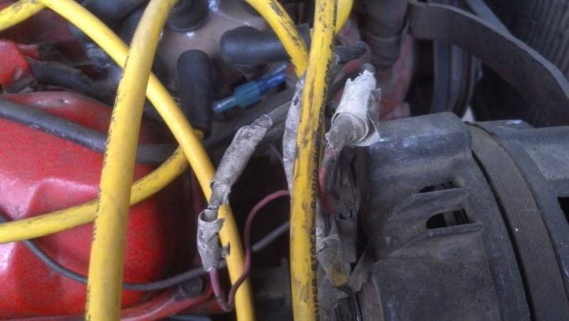

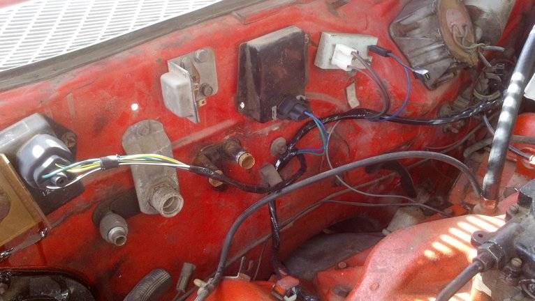

The first thing I did was replace the engine harness with the ones from Year One. Looks a 100% better and not worried about all those crazy splices they had going on.

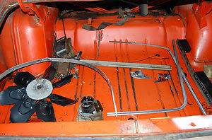

Then I bought new radiator hoses. Put the fan in the trunk back on the engine.

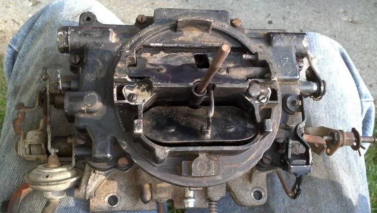

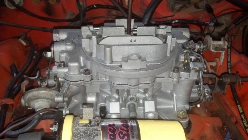

Had the carb rebuilt ( 69 avs). I probably should've just bought a new one but oh well..

The guy that rebuilt my carb does allot of work for a mopar restoration shop near by. With what he had to work with, I think he did a pretty good job.

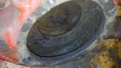

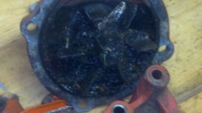

I did how ever bolt up my old AFB electric choke carter. I got it to fire up finally. Sounded pretty good. There was a rattle coming from the exhaust. I hooked the timing light and it was showing the strobe down on the balancer before the 10* mark. I assume the timing is right, cause I advanced it and it wouldn't run. I ran it for about 10 minutes and it started to over heat. I took off the radiator cap and started it again (after it cooled). I didn't see the water circulating. I think the water pump is shot. I'm gonna try changing it out tomorrow after work. So I wasn't able to take a video with the over heating issue. But I will once I get that sorted out. And I'll post it here:sunny:

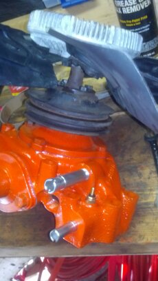

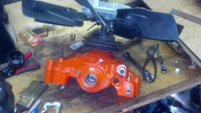

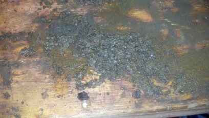

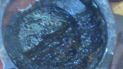

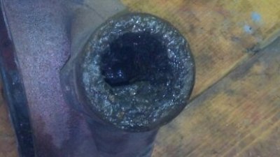

No go on the video today either. Found out why it was over heating, the water pump housing was plugged up with rust, lime, ect. Looked like gravel and was has hard as a rock . I chiseled away at it for an hour or so. Tried to take the heater hose nipples off. Nope. gonna need a good torch to get them to budge. Also the sending unit came out. Well the guts did, the outer threads of the probe stayed in it.. Nice. Gotta love it...1348968121601.jpg1348968120345.jpg1348968121852.jpg1348968119124.jpg1348968118607.jpg

Update on the carb, I took it to the guy that worked on it. He bench tested it in right then. No squirting. Took the top off, put the accelerator pump in the carb and pushed it down, squirt squirt, put it all back together same thing as before, after about 30 minutes of checking and measuring, cussing.. He had another customer come in wanting exhaust work, so he asked if I could leave it with him. I said sure. So it certainly wasn't something I did.
Got some more progress done on the Charger. I installed the water pump and housing along with a new sender, heater hose nipples, and an after market gauge. The additional gauge is so I can actually see the temperature and just in case the stocker is not acurate or quits.
I also flushed the system and got black stuff and some rusty water out of it. Now its clean. Put some green anti freeze in it, hopefully that will stop the corrosion for a while. I was going to hook up the heater hoses to the heater core. But noticed that while I was flushing out the heater core, that water was dipping inside the car. So that will have to wait for another time.
