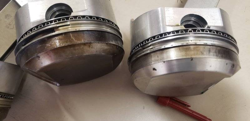

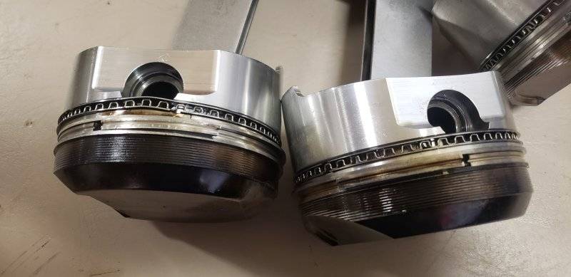

#2 piston had a portion of the ring land broken. That cylinder wall is pretty scratched up. The rest of the pistons had some light up and down scratches in them, and some had a lot of detonation, like little weld spatter craters.

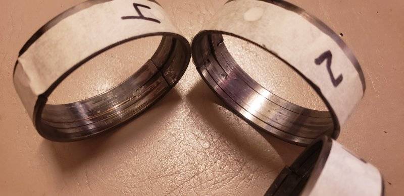

Thought some pictures might be helpful. Closer look shows three pistons with broken ring lands, and one of them has bent oil rings. Furthest right in the one pick has detonation craters. I had three cylinders down on compression, you guessed it, the same three with broken ring lands.

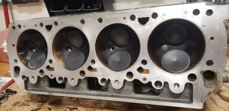

Have one head on the bench cleaning it up. The head is not to bad. Put a straight edge across the surface and it looks good. I will do an alcohol test to see if the valves are sealing.
Are there support rails under the bottom oil ring. I believe they are recommended when the pin hole is into the ring land.
