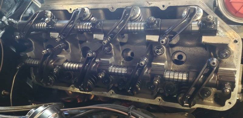

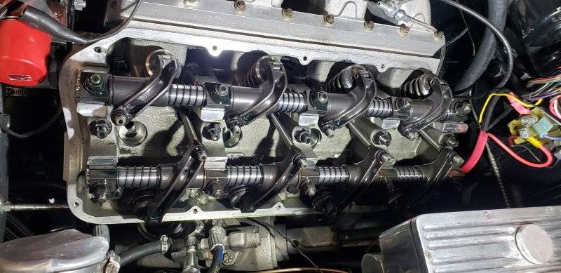

Indy Cylinder head 528 ci Hemi. The valve train is very noisy. I dont know when the last time the lash was checked, if ever. I pulled the valve covers to have a look around. The cold lash settings on the intake side were from .015 to .026, exhaust side .014 to .050+. I have no cam spec other than a mechanical roller. Where is a safe place to set them too? I have them all at .015 right now. Valve covers still off.
