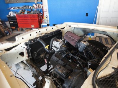

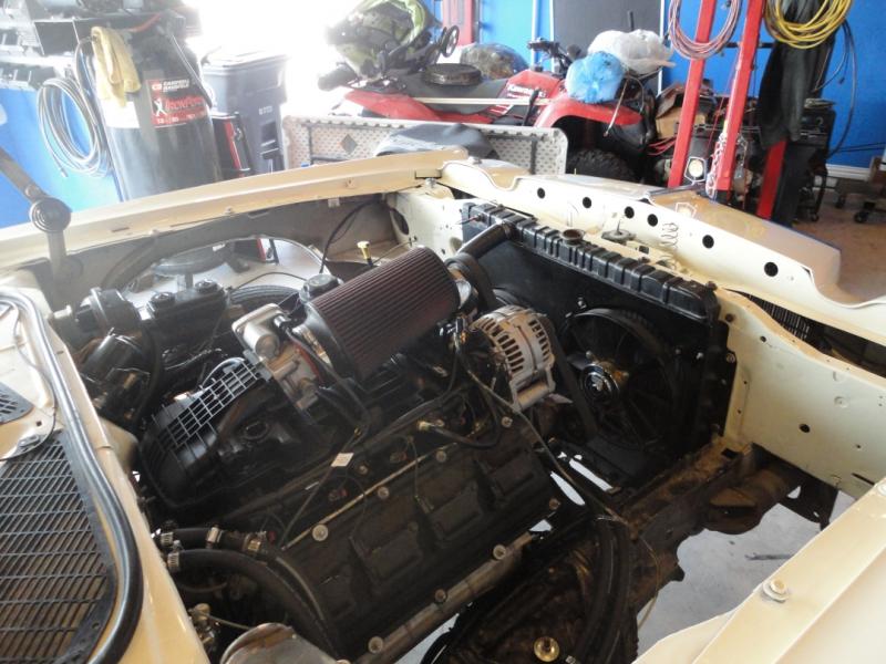

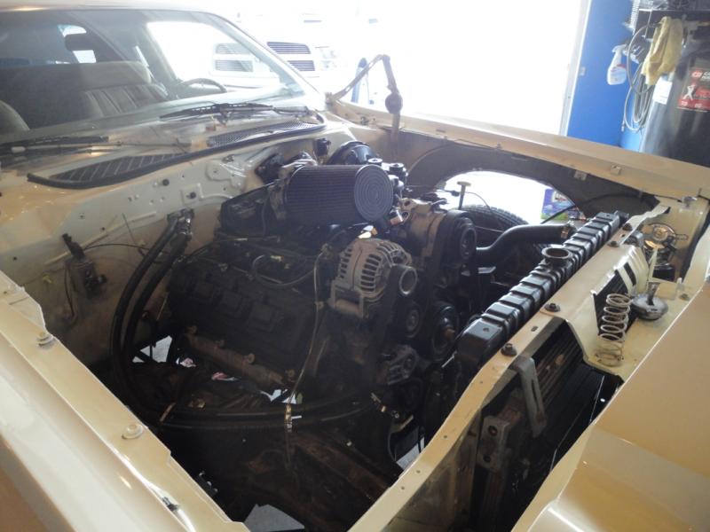

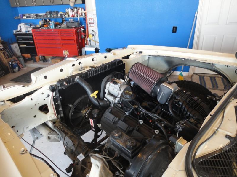

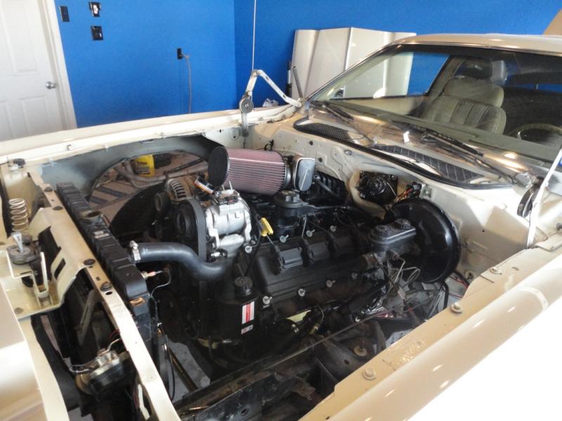

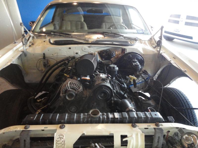

Here arepics as promised. The filter is temporary, as I am waiting on all the parts to come in to fab something up. I plan to run a single 4" tube to the passenger wheel well where the evap canister once was. As of now I plan to cut ahole through the flat section of the inner fender right behind the radiator core support and let the filter mount under the car. I have a half cover for the filter to keep it dry. I also dont drive the car in rain or bad weather so I sholdt have to worry much about water and road debris.

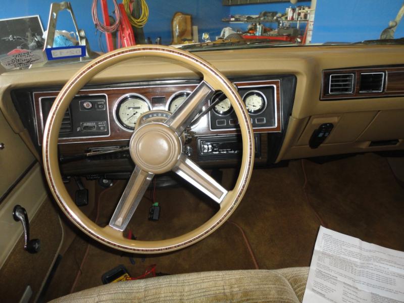

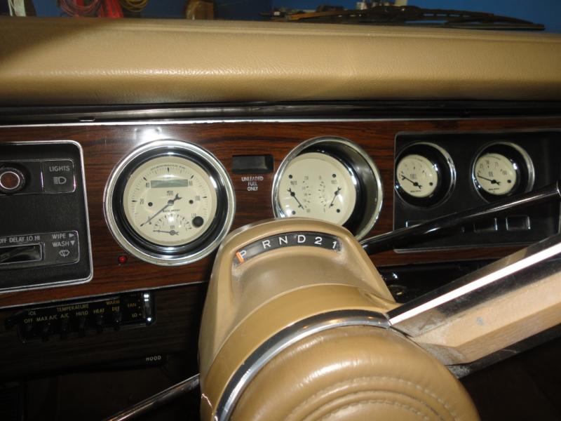

I also installed all new autometer gauges. Most of the factory gauges didnt work well or at all and since the speedo needs a cable to drive it I would have to swap that anyways. I used factory bezels and tapped the dash wires for the fuel gauge, lights, and turn signals. The oil and temp are in the new harness as wellas the speed output signal. I useda dakota digital tach adapter for the tach since the autometer adapter requires that you cut the ground wire for each coil pack. I paid 1k for this harness and didnt have any plans or hacking on it. The dakota digital only requires that I tap one coil pack ground.

The box hanging from the dash in the 1st pic is the tach adapter. I was in the process of installing when I stopped for pics.
Also had to install a different high beams indicator since mine never worked and I removed all of the original black pastic behind the dash. I bought a small black powder coated aluminum housing LED from oznium.com andmounted it straight down from under the dash pad just to the left of the speedo. You can see it in the last pic a little. I didnt want a light glaring at me when I drive so the glow is enough to know the highs are on but not melting my eyes at the same time.
is it the pic angle or does that engine really lean back? is that going to be ok for oil delivery? gotta love the removable wheel well houses. the gauges look great
Gauges look real good,but doesn't the front of the engine sit high?
its the angle of the pic, and the front of the car is on jack stands right now. I took out the torsion bars to install coil overs but the way the factory did the suspension it isnt a simple swap. I am going to fab up a upper control arm mount and use the magnum force k member and arms. When I re-installed the torsion bars I set them a key off I guess because when I let it down it lays out. Its was a pita and I do not look forward to doing it again. Its strange because I didnt really move anything when I pulled it all out, just loosened the torsion bolt enough to release pressure and slide it out.
As far as oiling goes, I dont think it will have any effect. I placed the remote oil filter right behind the pass. headlight and the cooler is in behind the grill. I mounted the pressure gauge there and it reads normal, and when I was priming the motor it was moving some oil pretty quick.
