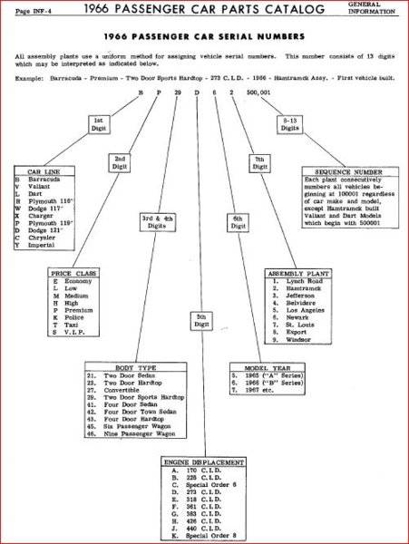

It was an unmolested '66 with a 440. I even remember him pointing out the digit in the VIN saying it was for a 440. Wish I could remember what the digit was.
Well there was no way it was a 66 with a 440 unless it was put there. My dad has a 66 and the engines were 318, 361, 383, 426 hemi as far as V8's go. No 440 offered in them until 67. The letter in the VIN that called out a 440 from 67-69 as an L. Now if someone changed the front turn signal trim out on the fenders and the full length console, it could have been a 67 with the 66 pieces on it? They weren't that much different to the common eye and looked identical if you weren't sure what details to look for.
Agreed. while it was known that you could order almost anything if the dealer knew how, the 440 was a C body only engine is 66.
440 was "J" and "Special Order" was "K". See below

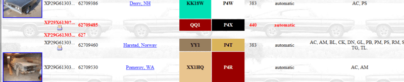

I did a little poking around on the 66-67 Charger registry site last night and found 2 '66 Chargers with 440s and a 5th VIN digit of "X". I'm not 100% sure, but I believe X is what my uncle told me his 5th digit was.
http://1966-67chargerregistry.com/list/indv.php?year=66&pic=1228238
I’m not seeing anything from the factory on that page documenting anything. There no fender tag, broadcast sheet or window sticker. Only text on a page.
Memories are great but they fade over time or we “misremember “ key details. Proof lasts forever.
