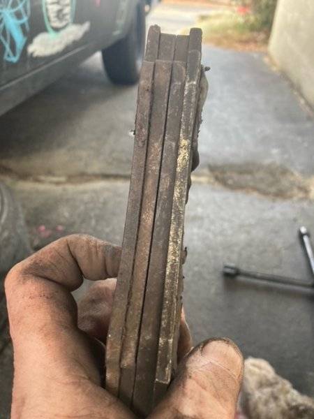

i have 1967 Belvedere II coupe, chalkboard edition, the guy i bought it from swapped out the console to digital, pulled his race engine out and put in a 360, its in decent shape, a daily driver around town, here where it gets interesting....
i could never get it lined up properly, I've had it about 3-4 years, always pulled to the left, so i decided to buy my own alignment kit and do it myself.
so far i found a bent strut rod on the drivers side and the driver side caliper is dragging and it seems like the spindle or caliper bracket is bent, the brake pads wear unevenly, see pic.
tire is wearing unevenly of course, tow was out. i corrected that with my tow plates
so my questions are:
what does a bent strut rod do? could it be responsible for the uneven brake pads? i don't think so but need confirmation.
Are the uneven brake pad wear always a bent spindle or caliper bracket? i think so but need confirmation. i already swapped out the caliper once thinking it was binding, got the same results of uneven wear of pads.
Where to buy strut rods, seems only the adjustable ones are available, any suggestions? what is the official length of a 67 strut rod, incase i buy the adjustable ones.
Where to buy spindles\ caliper brackets for 67 Belvedere II with the disk swap already done.
Any other suggestions to check the lower control arm? is it just a visual inspection?
any other info relevant?

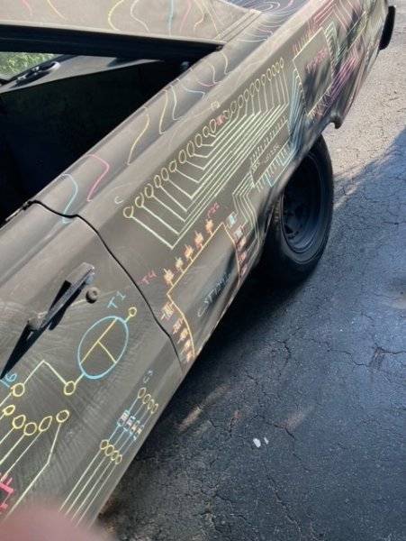

Welcome from CT. You put the hook in how about more pictures.:lol:Looks like a wiring diagram paint job. Bent strut rod will pull lower control arm forward, bad. Put a want ad for one. Start a thread about other issues Classic Mopar Tech section.
Welcome to FBBO from New Zealand.
As far as a bent strut rod goes, depending on bad the bend is.....it shouldn't affect the brakes wearing unevenly that I am aware of. If the bend is severe, it might affect the alignment. But I have seen worse - where a guy shortened a strut rod by 3/4" to get it to fit on a car with a bent front chassis. That is bad, and that will cause all sorts of issues.

Looks like 2 different cars in pics. Both driver's side with different graphics.
You need to know what brakes were swapped on to the car.
Slight bends in strut rods look and make you feel worse than they are.
Put up a WTB ad, and I'm sure someone here has a parts car.
Dragging brakes will definitely cause a pull. Fix that first.
