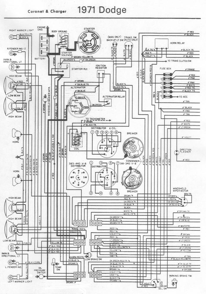

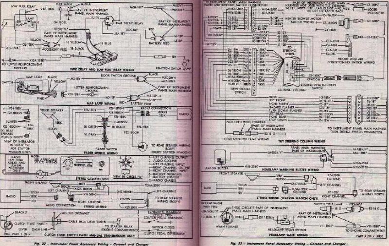

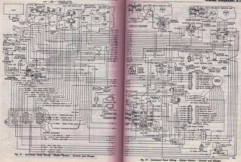

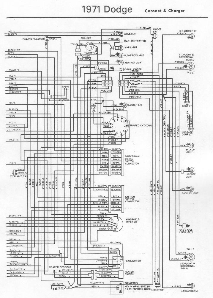

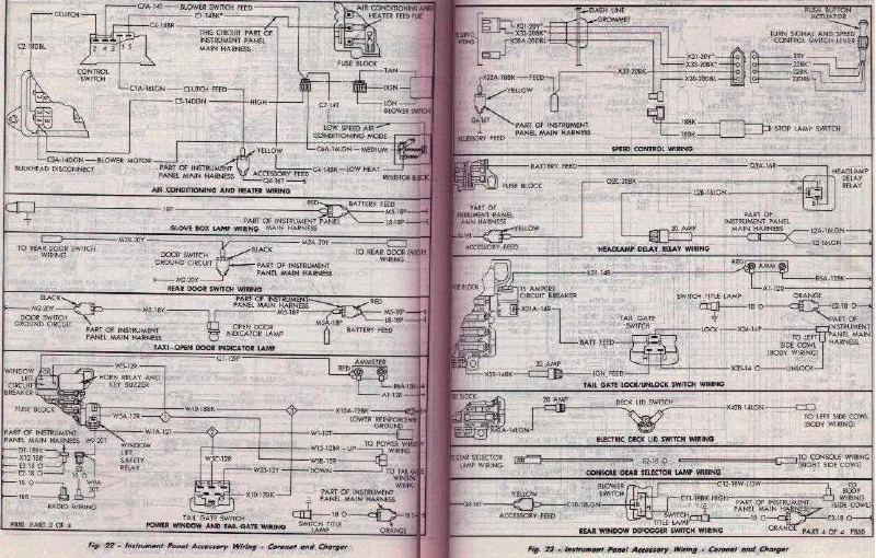

I'm sure it's been posted before, but is there a schematic for putting hidden headlights in a non-HH car?
Finding a HH harness is probably not gonna happen.
Actually there is a harness on ebay right now. Schematic may be easier to find on !971-1974 Charger website in the garage forum.
I'm sure there's more to it than just the harness anyway....
Stop/limit switches, relay, different switch on dash, etc.
I have the actaul grille, a motor and bracket, and can fab the rod.
