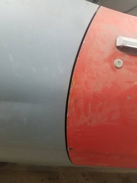

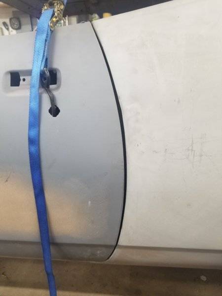

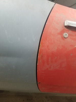

Hinges are rebuilt.
I set the doors for the 1/4 panel replacement. Do I also need to set fenders?
If the doors are aligned to a) the quarters b) to the sills and c) to the cowl, that should be sufficient.
I'm no body man but I would personally be inclined to install the fenders and doors before final setting of the quarter panels.
Doors and fenders have adjustment quarter panels don't...
So I'm assuming that adjustment at the cowl is automatic if your good at the 1/4 and rocker. It would seem that any movement up or down in or out at the cowl would change the 1/4 or rocker lines.
