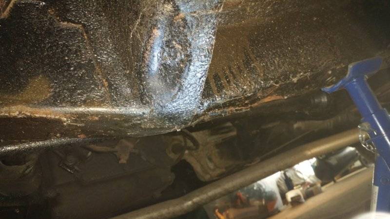

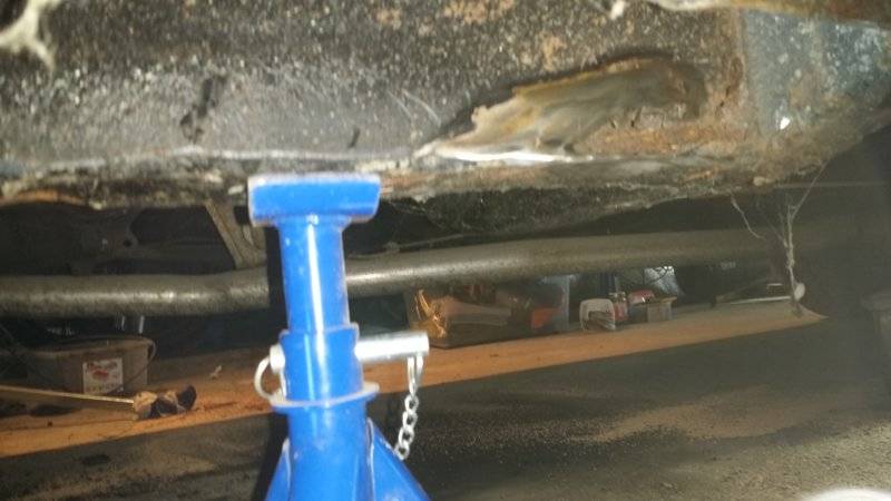

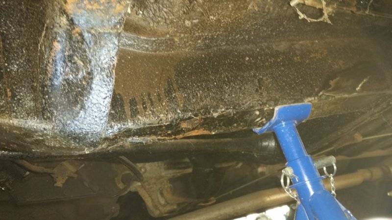

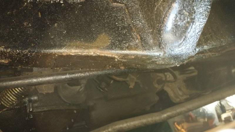

Hi there,

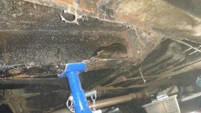

Today i wanted to bleed the brakes to check out why my brake warning light isn't going off. I started to jack the car up at the front driverside corner, and noticed that the subframe looked kinda soft when i was pumping up the jack. On closer inspection i found a hole in the frame, a welded patch and a frame that looks a little dented here and there.
Any ideas or opinions? i have enclosed a few pictures.
regards. Willem

Can I make a suggestion? get some better stands.. Ive seen those fold under weight..

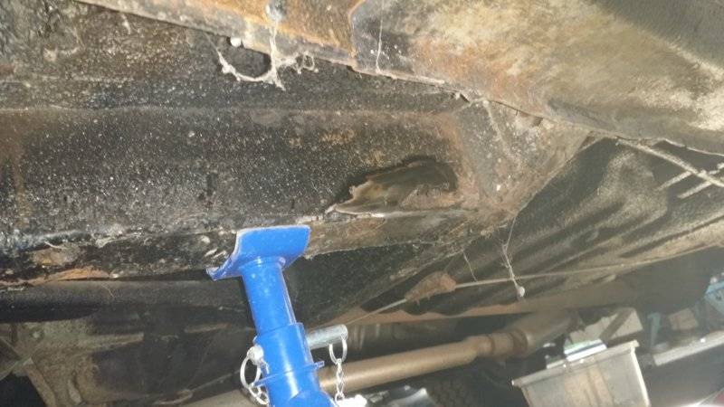

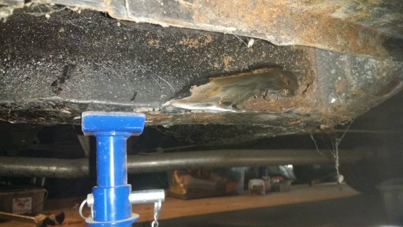

On the bottom it caved in a little. on the side where i grinded of the paint, there is a hole
Weld it up.. if the hole doesnt belong to anything.just dont grind it smooth.. so your not removing any metals off to the sides of the weld.. you have access to por 15?
here's the hole. I circled it with a red line. Is that safe to patch?
It depends on what the entire rail looks like. My 64 had mouse nests next to the K frame bolts. It was thin there and cracked. I cut it out and welded in a patch. No big deal. Now if the entire inside of the rail is all rusted that's another story. Get a $20 optical camera foe your phone and take a look inside.

Cross that bridge if you come to it. I've been pounding on my 64 for 7 years. Yanks the wheels every pass. No issue with the repair.

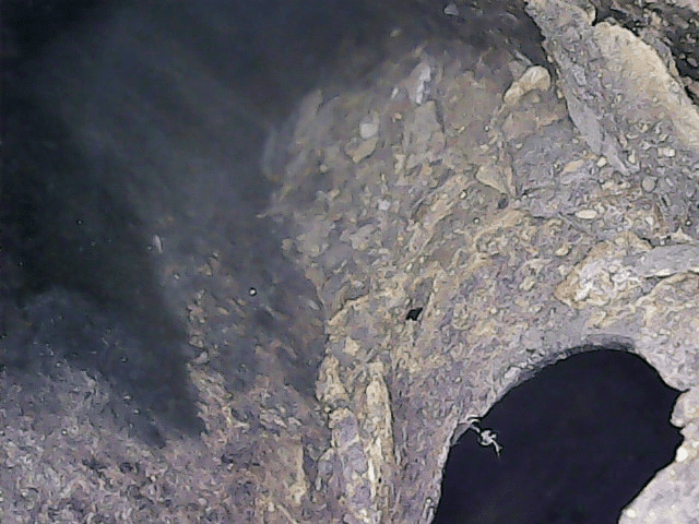

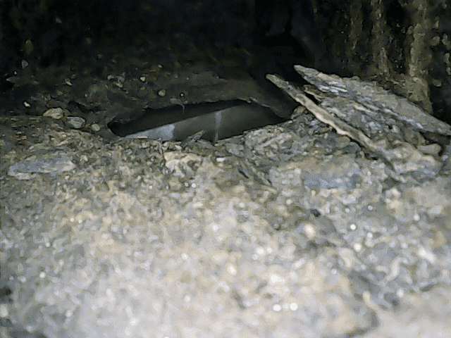

Hi there,

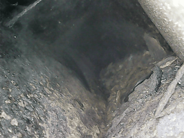

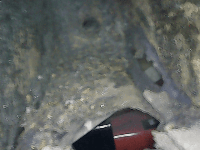

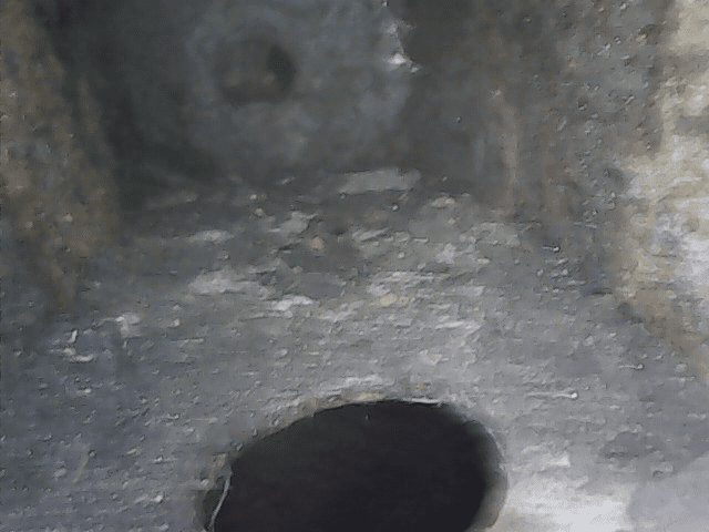

I have made the pictures with the endoscope as dvw suggested. Below you can see what the inside of the rail looks like. As a comparison, i have also enclosed a picture i made inside the rail on the other side (that one looks ok i think).
What do you guys think we're looking at here? Is that green stuff rust, or old dirt, or maybe some old coating that let go?
regards. Willem
