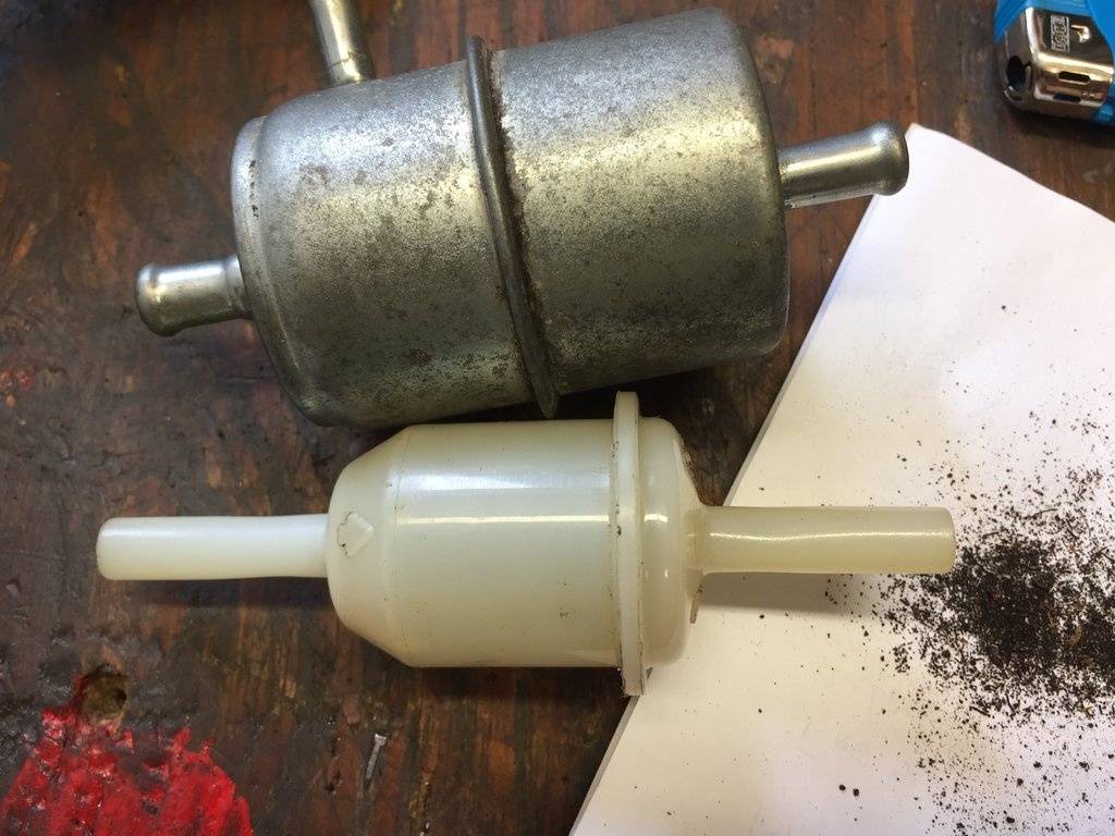

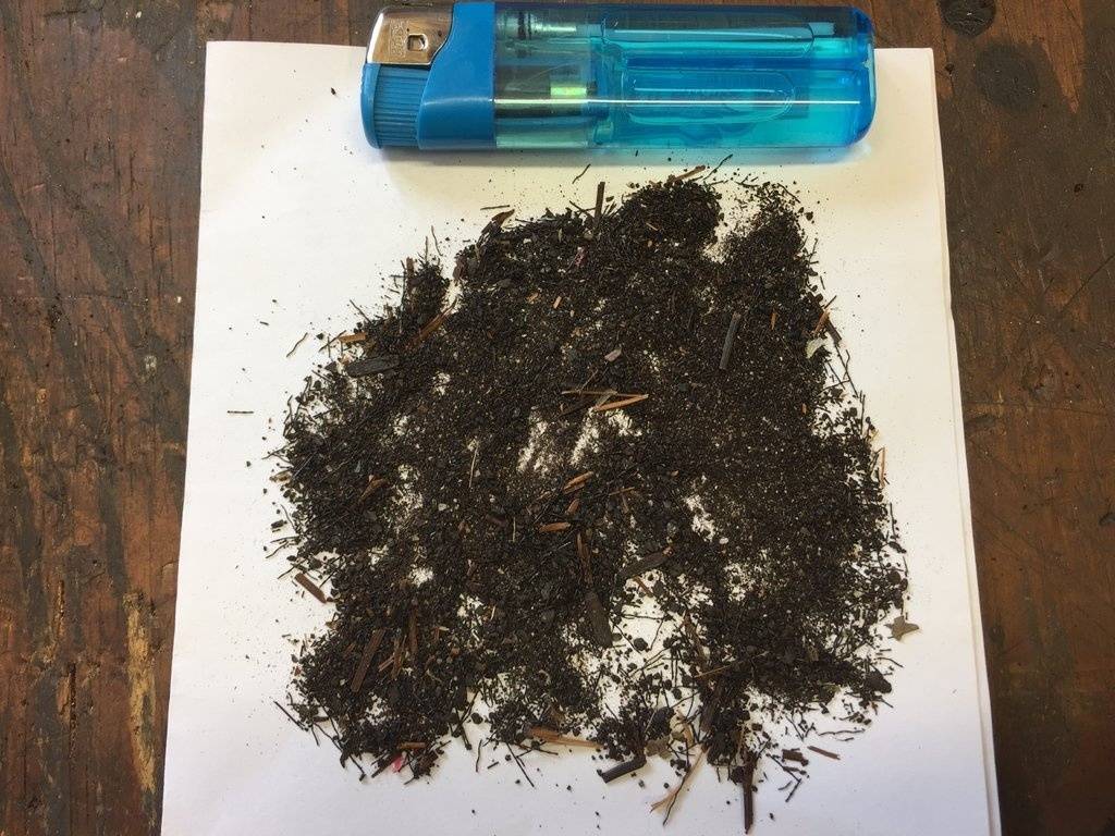

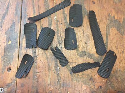

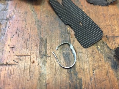

I removed the fuel filter and blown it dry with air, after some tapping on the workbench i noticed some shite came out and continued tapping the filter housing till everything was out, see picture. (no the lighter was not in there but just for reference)
After i reinstalled it and as a precaution i installed the new inline K&N fuel filter i ordered previously.
As i need a fuel filter with 3 connections, which i don't have at the moment but will order a new one.
It already had an additional inline filter which was clean so i am sure all dirt stayed inside the first filter.
Now, while i am at it i am installing my new alternator as well, once done i will give it a try and see what happens.
So did some test driving and it looks like the filter caused it. (no wonder with that much **** in it)

Good heavens! What is all that crap in the filters from??. That confirms my thought on your problem --fuel starvation. Are you using ethanol in a possibly dirty fuel tank or old gas lines? especially if any are rubber. That stuff will break crud loose and plug fuel filters.
#88 jets should be plenty on primaries, and may be a little rich
Unless it is a 20+ year old Holley, the power valves will not blow out with a back-fire.
Power valve--engine vacume closes the valve, which blocks a portion of the circuit. --punch the throttle=engine vacume drops-power valve opens up , and supplies additional gas. The number on the power valve is the amount of vacume at which the power valve closes--drop below that vacume and the power valve opens...It's actually a fuel economy thing..............MO
Yeah it was a lot indeed, i found small parts of rust, splinters of wood and steel wire.
The steel wires look like coming from a small wire brush, but my thought also was from a filter/screen so thats why I installed the K&N fuel filter as wel in case that filter is damaged.
Probably the fuel cap was left off during a restoration job and allowed all that **** inside.
View attachment 495958 View attachment 495959
Holy sheep **** that's a lot of junk in the filter!!!! I strongly suggest that you buy 4-5 fuel filters & swap them out every week for a month to catch all that garbage. I think you've found your problem.

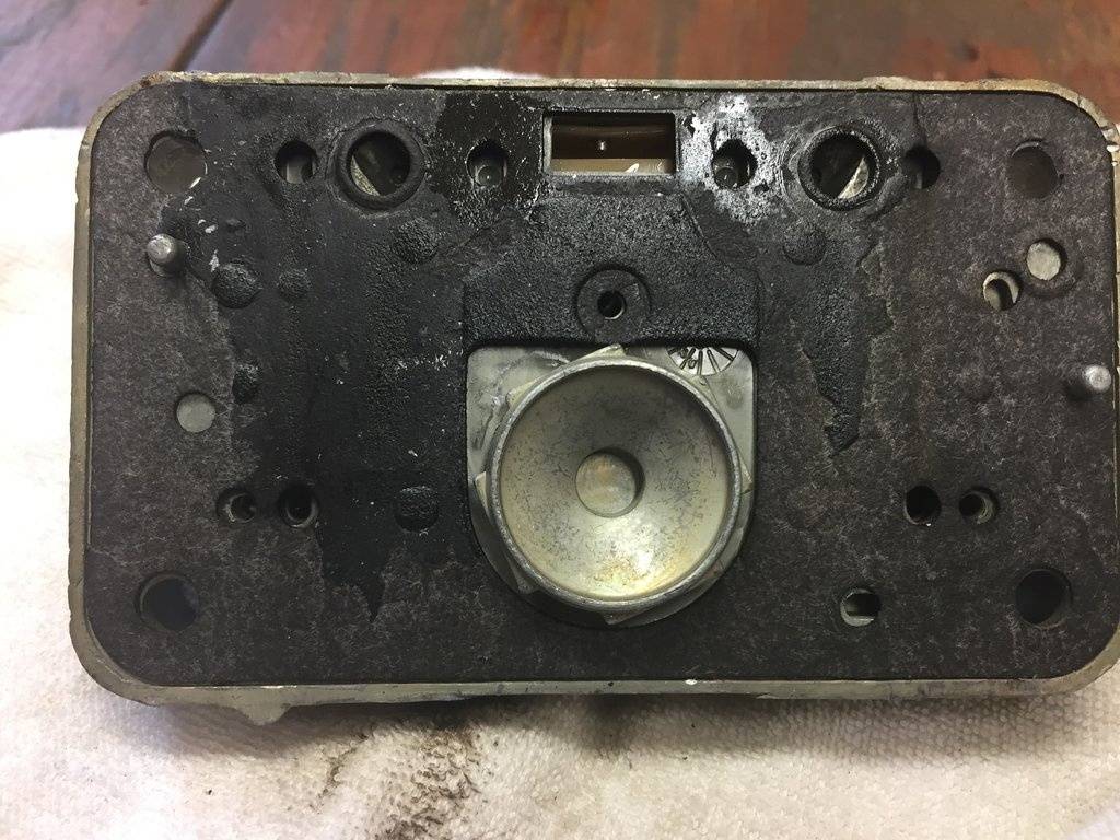

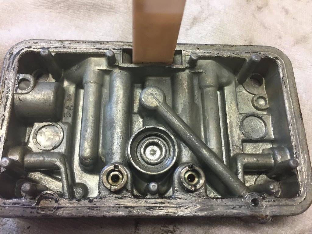

I decided to go ahead and open up the secondary metering block.
I found the power valve to be a blank dummy??
Jets are size #84.
Did not find any dirt or blocked channels.

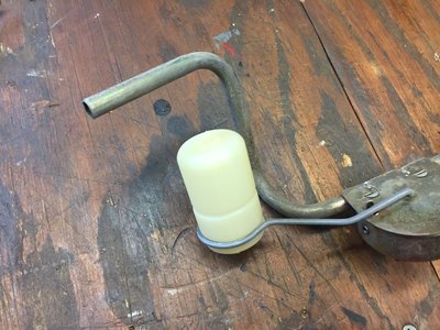

Only abnormal thing i found was that with the current fuel bowl setting the needle is squeezed that tight in it's seat that it gets kind of stuck, with knowing the fuel pressure will be very low as the primary is also taking max fuel from the line it might not be able to open it up and run the secondary fuel bowl dry.
I backed it off a full turn (increasing the level) and will build it all back and see what comes out.

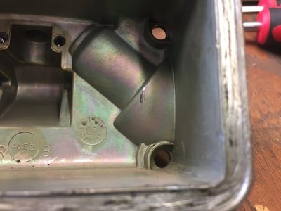

When building it back noticed as well that the float was touching the housing, limiting it's movement down.
Due to this the needle valve will not fully open and feed enough fuel to the bowl.
See the scratch mark on the housing, just had to bend the float arm a bit to straighten it up with the housing.
Guess this issue is solved once it's back in.
