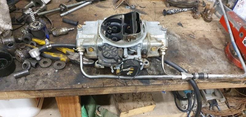

Hi,
I need a rebuild kit for my holley DB street avanger
Its an older one.

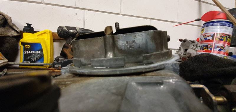

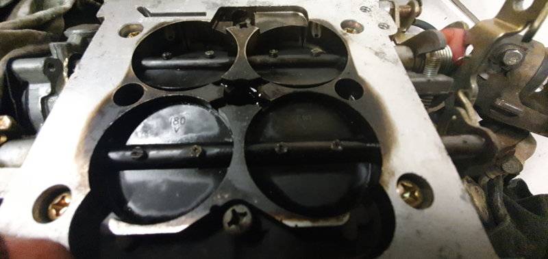

Only # i have are on the butterlys and is 180
On the top it sais 80870
Can anyone tell me wich kit i need?

Look for the list number on the carb and that will tell you what you need. Holleys go by that number for the kit
If the # on the choke tower is 80870, that's what you need to find the correct kit.
Holley 80870, 870 cfm, square bore, vacuum secondary's.
