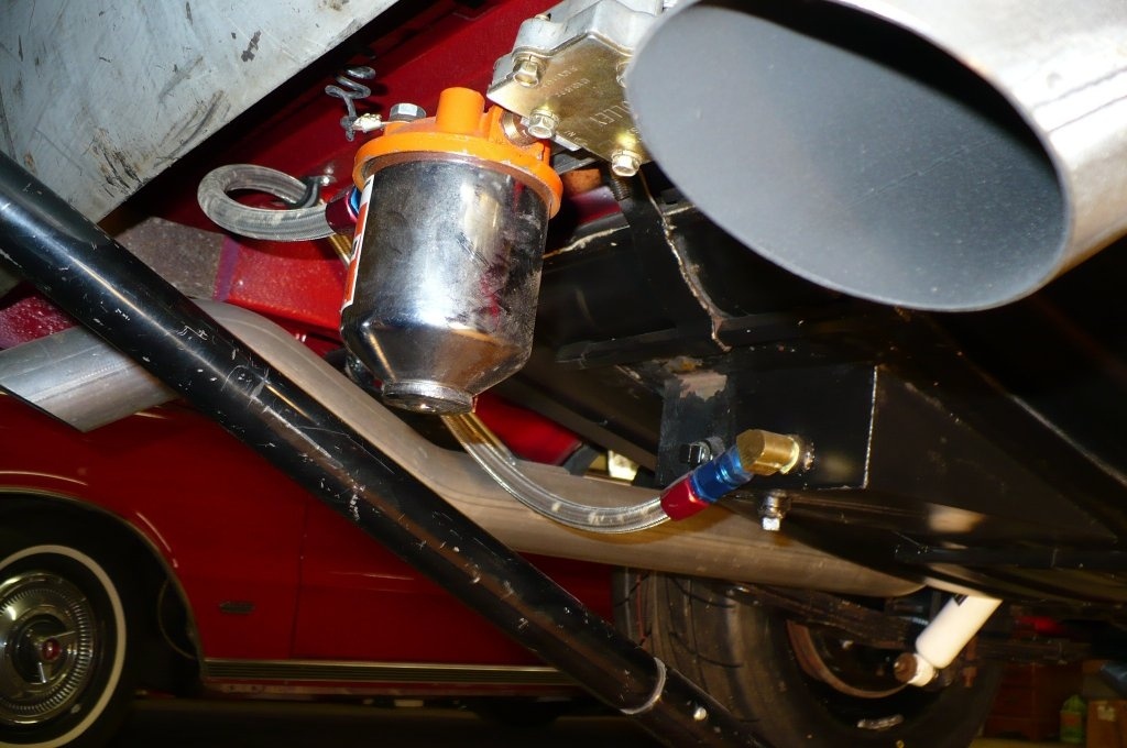

Competition Engineering sump and an inline pump is the easy way out. When you add it to the bottom of tank you don't cut one big hole but a group of smaller ones.
Who said Hot Rodding is easy!
