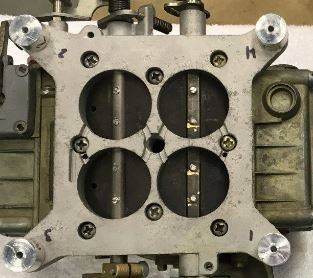

Hello. I need to adjust the vacuum secondary throttle blades to allow more air in so I can close down the primaries. How far can I go before engaging transition slot? Is it the same as primaries with the square method? Does the transition slot pull fuel at idle or only when the secondary vacuum is engaged? Sorry if this is a dumb question but I'm still learning. Thanks!

I adjusted already but it seems like it needs even more air but I just don't know at what point it starts pulling in fuel or if it even will since the secondaries shouldn't be engaging until vacuum condition is met from what I think but I don't know how the transition slots work on the vacuum secondary side so that's why I asked here :)
Also I do have a very large cam with only 6 inches of vac so I'm having to make outside the box adjustments to get the rich idle down. If I completely seat the mixture screws it doesn't turn the engine off and in fact idles even smoother.

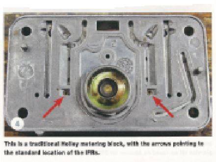

You could experiment with small pieces of wire in IFR's red arrows .020 or so. Bend wire L shaped.
So here is where I am. With throttle plates set correct I idled around 1100 rpm. But I can adjust the curb idle down to 850 and it idles fine. However, it still smells super rich and seating only one needle on the metering block has no effect but if I seat BOTH needles it will begin to stall.

I went around my garage with dial vernier calipers found wire. Phone wire door bell wire. The idle feeds on my carbs were huge .058. Race Hemi 3116 carbs, bought an NOS metering block for the carb same thing. Your IFR's could be smaller .039. You could check 12 gauge multi-strand wire or other gauges. Just experiment with different sizes, a Little light grease make it easier to keep them in place. The picture show a more permanent solution but experiment with wire to see if it helps. Set go in top tapped hole.

If he is turning the idle mix screws all the way in, and it still runs, nothing he does with the IFR is going to help as it's pulling fuel from somewhere other than the idle circuit.
