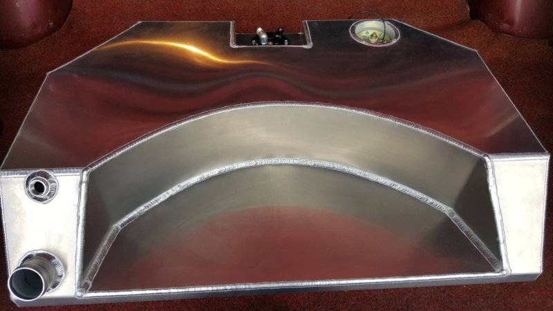

Unfortunately tanksinc and other companies that I found don't make a efi ready gas tank for a 66 coronet. Does anyone know of a custom tank builder that could handle a job like that?
I bought a custom tank from Hot Rod City Garage, for my 67 coronet.
