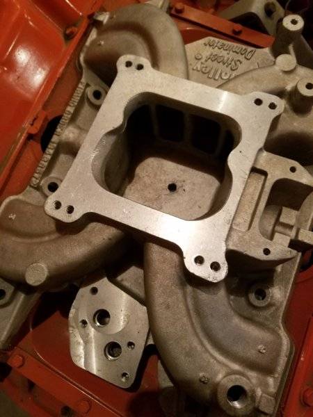

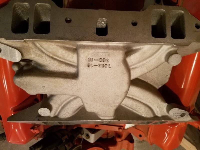

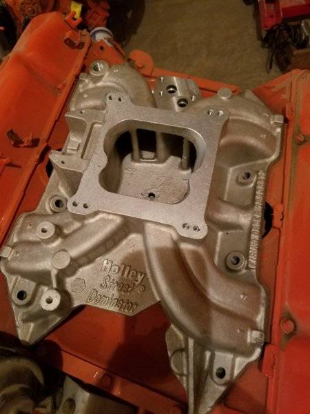

Ended up buying the one I found. Figure I can always sell it if I don't use it. New, never used but siting for awhile. So if anybody is curious, it is 15/16" taller than a stock 383 4-barrel intake.

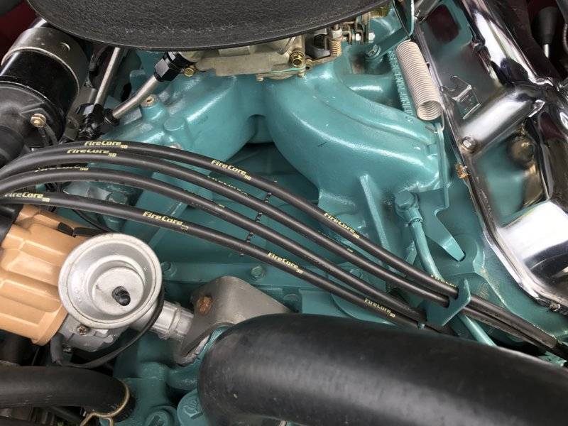

Nice! The Street Dominator on my 451 69 RR fit really snug, with the 440 base, and air grabber hood.
I cut and blended the flat part between the front two runners out of my street dominator.
Gets rid of the Holley advertising and looks better IMO.
Are you able to use any carb spacer at all? I like to run at least a 1/4". From what I am reading, the 440 base is 3/8" shorter than a 383 version. I'm not certain how much leeway there is on the stock setup. Was thinking of using a solid motor mount on the drivers side to eliminate any motor twist when the clutch is dumped.
What did you guys do with the EGR stuff. Seems like it would be nice to tap and plug the hole in the bottom of the plenum instead of rigging up a plate on the exterior? Or maybe do both?
I would definitely put a solid motor mount, or a torque strap on there. I did. Don't remember what we did with the EGR stuff. Seems like it never was even an issue. Maybe someone had plugged it before we got it, or it was one that didn't have that feature. Put it together without a spacer, then check your air filter to hood clearance with some clay, to see if you have any room left.
