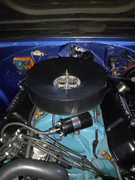

I made a custom piece that only uses an top filter element and then funnels down into the opening of the carburetor. No that home right now but will post pics if interested.
Hey thanks would love too see the pics and your set up .I was looking on manncini they have a drop down air cleaner that looks like the original got to check out more details on it but like to see what you got
Thanks would like to see the pictures and your set up wouLd like to use the rpm manifold I already have it from a race car project I had I also thought of going to the regular performer intake I believe it's a inch shorter but please send pics
So this my set up. I used the drop base, then welded 3" metal strip around and the another piece that slopes down to the opening of the carb.
Plenty of test out there that show the more you can direct the air flow into the carb the better. With this setup all the air is coming straight from the top and funneled down in to the carb . The car works very well so I can at least say it's not hindering anything!
That looks great nice set up so the open top filter works great? What was the filter you used ?how much hold clearance do you think you ended up getting? Thanks for the help
The filter is a spectra piece. There is maybe 1/4 " clearance .
