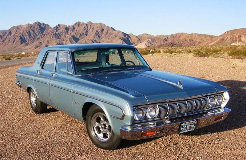

You can check with Sled City Fiberglass as they specialize in the early B stuff. Some photos for you of 63 and 64 cars.

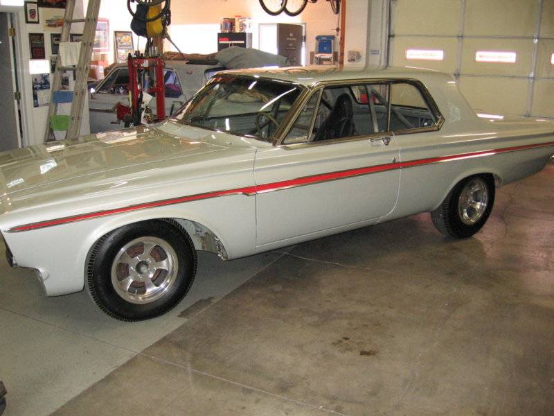

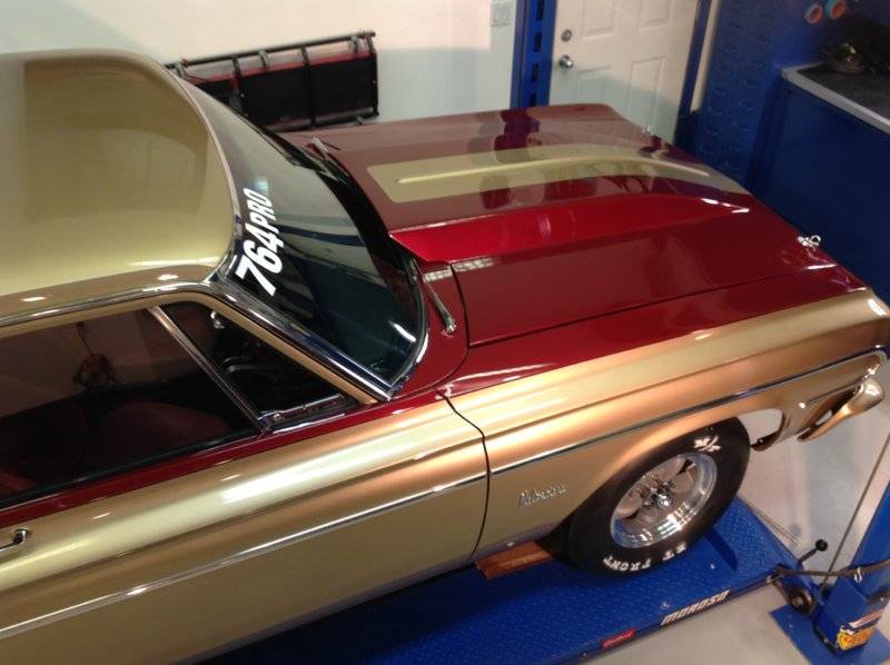

I thought for sure that the 63's differ from the 64's like furyus stated.First two are the 63 the last is the 64.

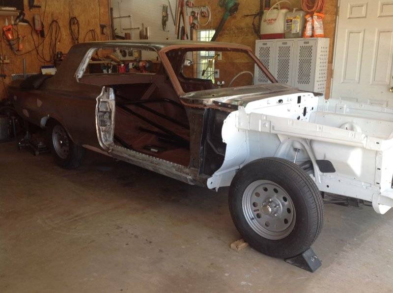

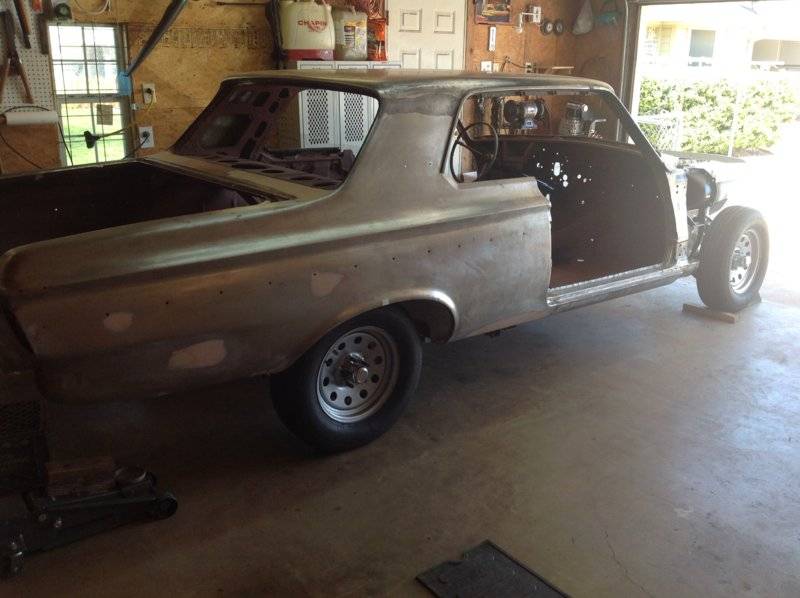

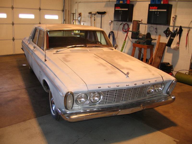

These are some pics of my families cars my oldest sons 68 Big Block Dart my 64 Plymouth Belvedere and our 63 Plymouth Belvedere that I’m trying to get together for my Mother and Father.

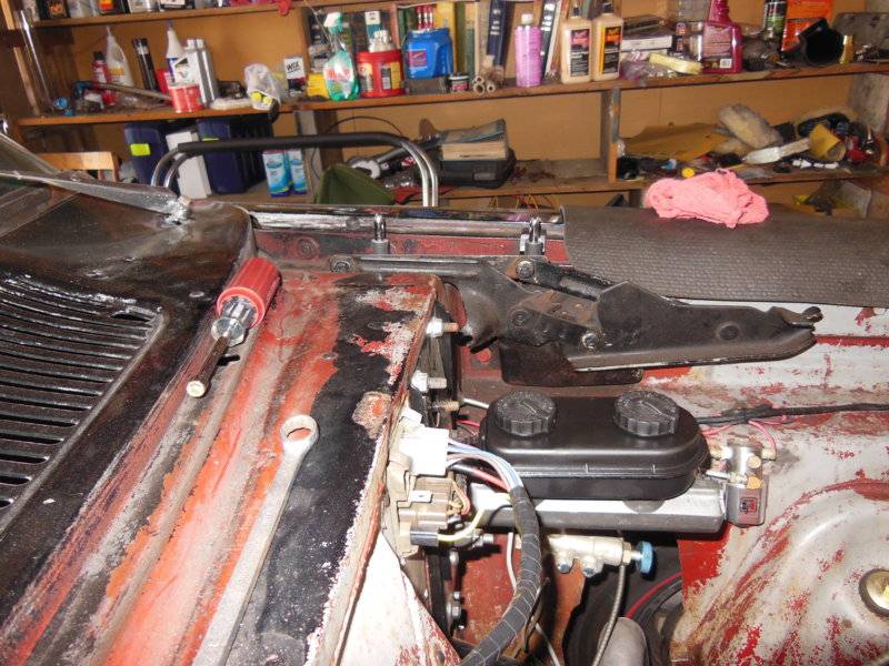

with my AAR hood for my '63..im using original hood hinges (no springs), installed 2 pins in each hinge,and pins in the front..will use a prop rod..now I can open the hood at shows and wherever just like stock,,and remove it completely whenever I like ,, really easily,,best of both worlds..
That's a great idea. Would love to see a picture of that but yeah, talk about simple.

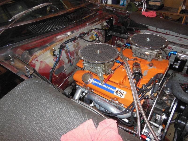

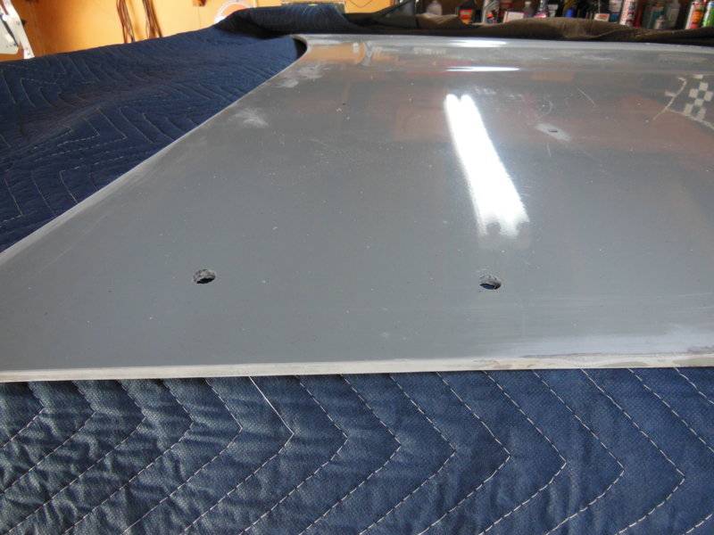

heres a couple of the mounts,and holes in hood,,original rubber grommets set ride height with fenders..hose on pins in hinges
puts it tight against hood..far as iv'e got so far..
heres a couple of the mounts,and holes in hood,,original rubber grommets set ride height with fenders..hose on pins in hinges View attachment 596919 View attachment 596919 View attachment 596920 View attachment 596921 puts it tight against hood..far as iv'e got so far..

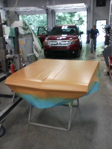

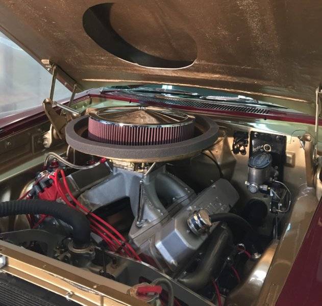

With the stiff AAR hood I could see this working. You will find that the hood hinge will open better with a bit of spring installed. I escapulated oak / bonded to the underside of the hood and went with studs. The main thing is, if a guy wants to be creative, you can make them hinge able. Hinges are 6.5 lbs each for those who are counting.

I think that's the only reason the ends were not broke off when it showed up loose in a cardboard box standing on end! not on its side..i think the installation is pretty much same as yours with the exception that there wont be any hinge/hood alignment work as before...much less anyway...the rubber shims put it in place...r those stock hinges...and what springs did u use...thanks..great looking set up..and car..

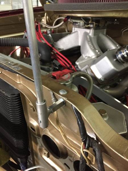

Yes I see with your set up you would adjust your hood and then lock nut your pins at the hinge slots. Yes I'm using 64 Plymouth hinges, and those springs came off the wall of Lowes. They won't hold the hood up, I have a prop rod for that, but they help make the hinge operation smooth especially when opening because the spring is helping lift.
Prop rod is 3/8" aluminum, from Home Depot. It drops down and snaps into a catch on the opposite side.
the prop rod is something I need to start thinking about,,,i just have not seen any that guys r using until now...as far as raising the hood..its not bad..i think the scoop('65 style)weighs almost as much as the hood....but overall its a sturdy piece...when done there will be a total of 8 hood pins..
