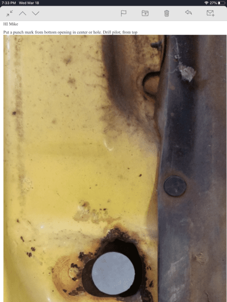

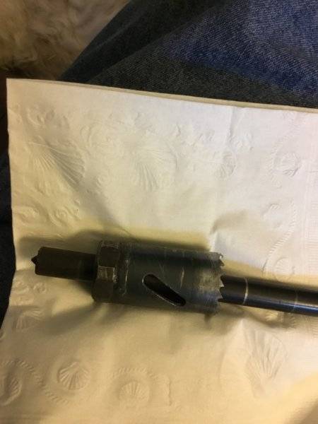

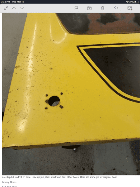

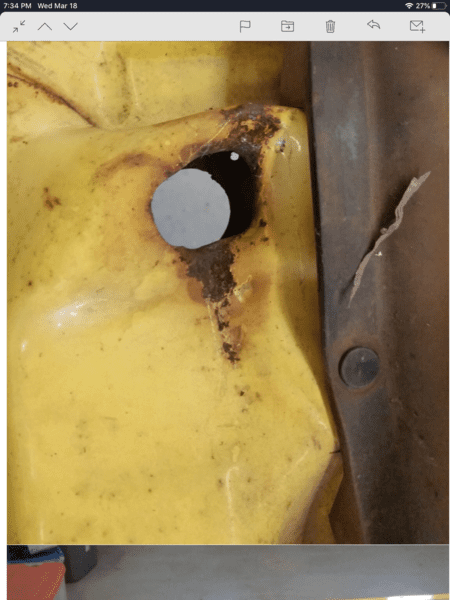

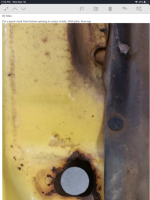

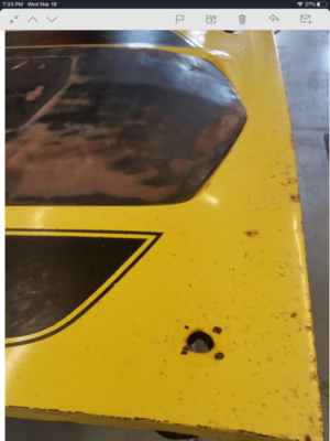

Jimmy Boros (airgrabber.com) sent these pictures and text for hood pin hole location.Hope it helps other members.I used a 1” hole saw upside down in the ovel shaped hood opening and a 7/16” center punch to locate the pilot hole.Worked great.

the frame on my 74 hod was already factory cut for them... so on skin is just about cut centered on the frame hole
