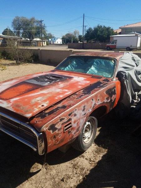

I am not sure what they call it. The is an R/T. The person who I am getting the car from has spoken several times about it having a tray that keeps water from building up on the air cleaner. He has been searching for it.
Here is a photo of the hood.

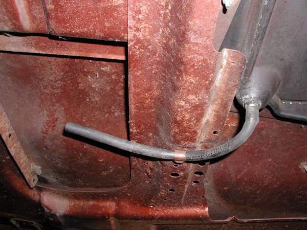

I know the SuperBee hoods had a drain as I have a picture I believe I took at Carlisle. I have only ever seen one and have never been able to find info on it. There is a gasket between the insert and the hood which no matter how hard you try, leaks. I can imagine a scoop would be worse. Here is the picture I have. Incidentally, my insert does not have this spout underneath.
The louvered hoods are a two piece design and the underside piece has a drain. If you only have the top part, the louvers are open to the engine compartment. These are hard to find, especially individually, and expensive if you can find them. I have talked to the company that repops the Super Bee insert, but they have supposedly been working on this for over a year now. I have not tried VFN, but you have to have an original to use as a plug for a fiberglass mold. I have toyed with this as a winter project but doubt that I get to it, plus, I was looking at maybe 10 people that would actually want to buy one at the price point I would be at to cover labor and materials for a one man amateur. At one time someone made a complete one piece fiberglass insert because I have seen two on cars but the louvers were not open.

That's a picture of the 71 R/T Louvered Drain
The Factory 71 Superbee Hood fiberglass section does not have any type of drain as its one piece and sealed to the hood
Both the 71 R/T and Superbee hood pieces will interchange between hoods as the hood itself is the same , only the center pieces are different

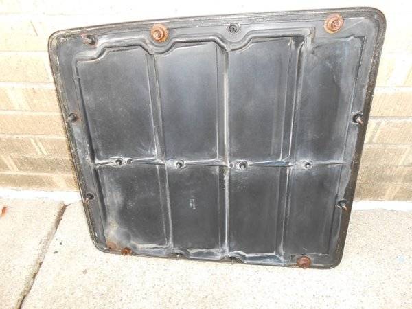

Pictures 71 R/T
Bottom picture you can see drain with missing tube and nuts that secure bottom section to louvered section

Most all I have found , crack around the studs for the metal attaching studs/cups that support it to the hood
As you unscrew the nuts , the studs come with it along with the fiberglass from old age and corrosion of the studs/nuts
R/T piece is damn heavy and metal of course

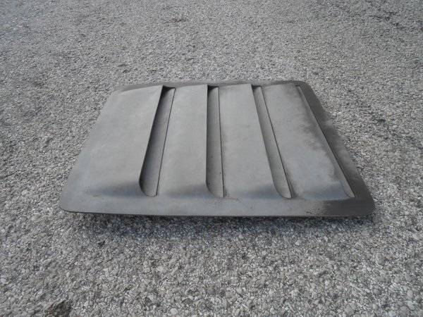

R/T Louvered Section , both pieces
That's where I got those pictures
