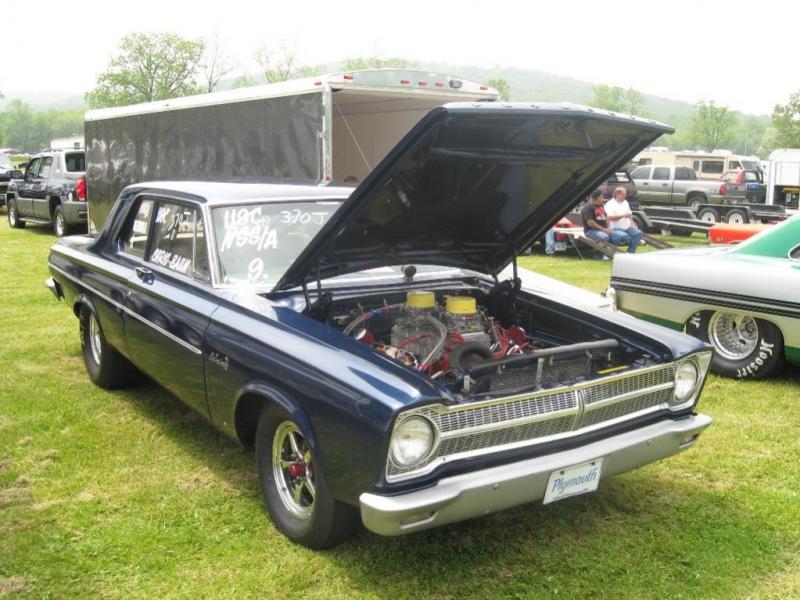

This is my brothers 64 and he runs this one. I would have to call him tomorrow to find out where he got it. Just let me know. Ron

My brothers has a tunnel Ram on it as thats why he needed the big scoop. Ron

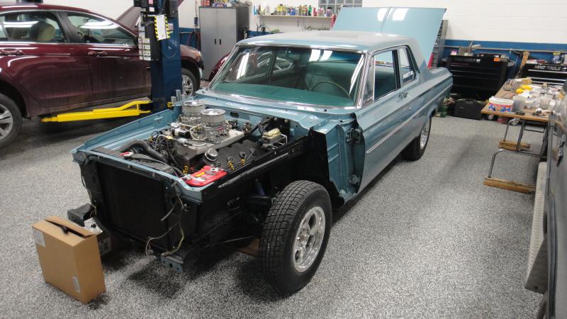

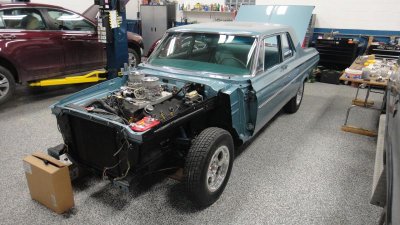

Thanks guys, I guess the problem is the combo of Indy 426-1 heads with the intake and carter carbs. The car is 2500 miles from me at a body shop.I'm waiting on pictures to see what style air cleaners hight/width to use.this is the last picture I have,it's my brothers car and I'm just trying to help him out.It's all done now(street car) and the little chrome cleaners won't allow the hood to close.Going to try Max Wedge style. or the 5 '' scoop as last resort like 383man's picture.

Hard to tell what you need from a fenderless picture without a hood on it. You need to know how far those tall air cleaners come through the hood. Until that happens you won't know how big of scoop you actually need. I go through this about once a week with people that call me about scoops. We are Sled City Fiberglass.

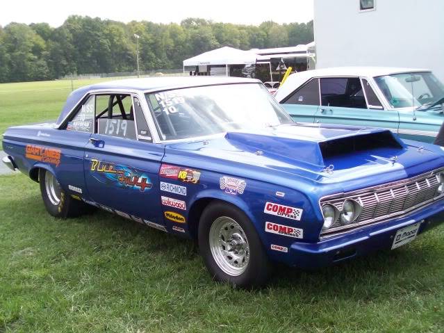

This is my Hemi scoop by the way, I like it:
